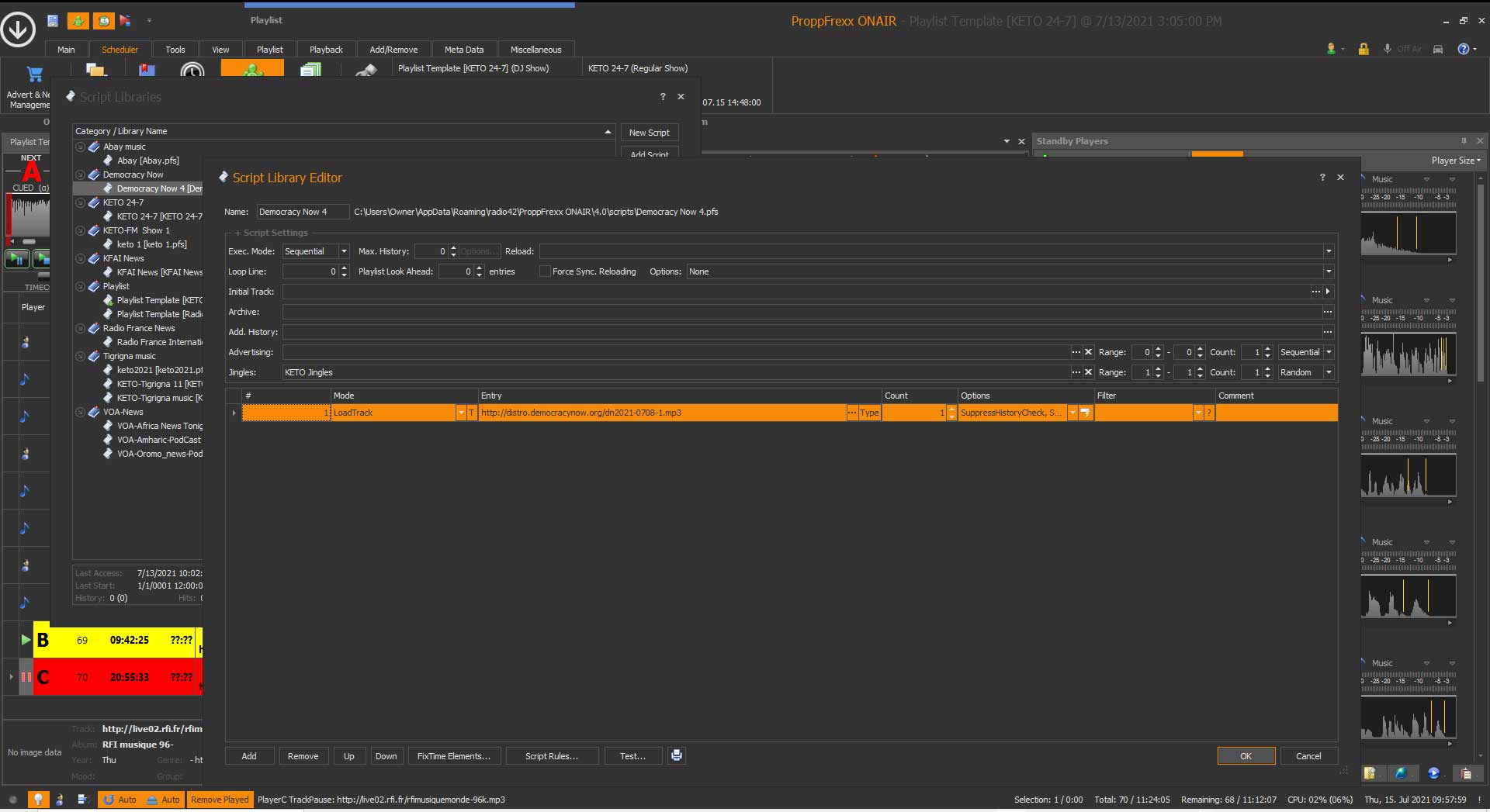

I have this news, I did just like you told me
4PM
But its not paling inside the program playlist
open its on playlist and its not stopping it loops never go back to my 24/7 playlist
how can i do this so the news come at 4PM its 1hr than go back to the show which is the program was on the air when it comes at
i like the RSS feed to play only at 4PM a day
go back to my program
how to stop it from looping...?

The name of the partner is Per Cramer and he has send you a mail, as I was on CC and saw it. Maybe you again did not receive any email, as you also did not receive various of my mails?! So you really need to check with your mail provider what the problem is and solve it.
You again did not specify any time limit with your URL (just as I told you).
Plus as explained in my tutorial videos, a program script loops as long as it runs, and until a new program starts.
In your screenshot I can see, that
a) no new program follows after your ‘Democracy Now 4’ (see what I explained before, because that is the main reason!)
b) you did not specified a time limit for the LoadTrack (see my other posts in which I explained it!)
c) the script only has one script-line, so that line will of course loop until a new script is started (else specify more than one script-line, but set the LoopLine parameter to 2!, just as explained in the tutorial videos)
But you really need to define a subsequent program to end the current one!
d) in your playlist the time it is 10:14:00h - so of course your scheduled program at 16:01:00 is not shown yet.
Again, a program script will always loop until it ends. And it only ends, when the next program starts. Ie. by default the EndTime of a program is ignored! The start of a new program will end the previous program.
To me it seems, that you really needs some help and training, so why don’t you write an email to Per Cramer (put me on CC) - I have send you his mail. This way you are sure he receives your mail.
Please try the following- else:
1) Change your script accordingly- add a 2nd script-line, eg. Random, Music and set the LineLine parameter to 2
2) Add another Program entry after the existing one to start at 17:01:00 Fixed and use a different script with that program
3) now wait until 16:01:00 and the Democratic Now 4 should start and play
4) and at 17:01:00 this additional program should than start…
