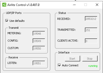

Airlite Control status?
Re: ProppFrexx in combination with D&R Webstation, don't communicate
I hope you have changed it on both sides: ProppFrexx ONAIR and the GPIO Client!
Further many systems don’t work with the local host address 127.0.0.1. So please use the real IP address instead.
