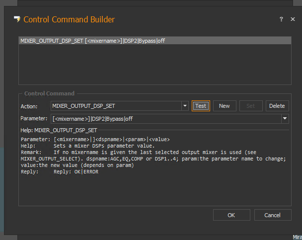

i'm trying to switch a dsp on and of via scheduling Command Control builder.
I used the action: MIXER_OUTPUT_DSP_SET
The parameter is: [Live|]|DSP2|Bypass|off

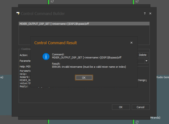

After pressing test i get this error.
Someone a idea?
Re: Error Switching DSP on and off
Yes, the command is incorrect.

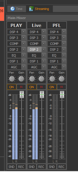

The parameters should be eg.
Live|DSP2|Bypass|Off
As written in the message, the mixer name does not match.
