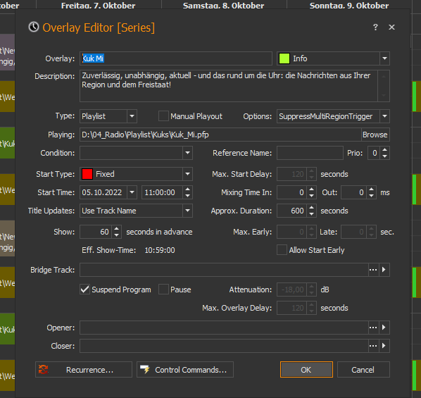

Hello,
we want to use our radio mainly automatic. So I have a program of Music as main part. This will be disturb by overlays. I have playlists in the Overlays, where some files in the playlists are changing. The path and filename are the same, but we replacing them every day. My problem is, that the overlays will not played full. The program starts to early and interrupt the Overlay. I think, the changing files will not be updated in the playlist. How I can update the files in the playlist automatically? Should I use another way?

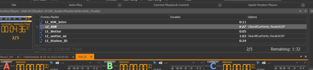

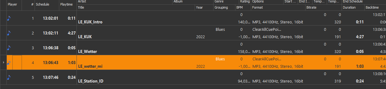

I took some screenshots. Maybe this helps to clear my problem.
I don´t know why the duration doesn´t change, when the file was change?
Playlist with the option you said<br />The duration is also not correct.
Overlay Values
Overlay Values
hThe Playtime/Duration of LE_Kuk und LE_wetter_mi are not correct

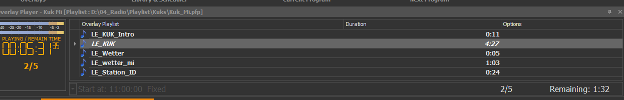

I took the wrong picture of the playout view. Here the correct.
Here with the options you are told and the duration is still wrong

I solved the problem by myself. I don´t use playlists. I use scritps with LoadTrack. That´s works fine.
Posts: 9141
Re: Auto Update Files
Now I got your issue. And yes, this is correct. When you assign a playlist to an Overlay, the individual playlist items/tracks are not (re)evaluated before loading them, ie. an overlay playlist is used as is - even if the underlying entry has changed.
Thus, it is correct to use the Script mode for your Overlay.
