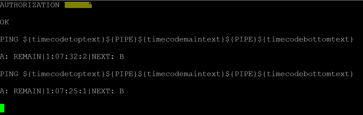

To retrieve a macro value, you can use the PING command.
Example:
PING ${cpltracknamecurrent}
This command will return the macro value of the connected instance. Other macros are explained in the appendix of the user manual.
In your program you can as such every to ofter PING the one PC to monitor eg. the time or state and when a certain logic is evaluated, you can send a command to the 2nd connected instance.
Use eg. putty tool in mode Raw to establish a connection using the host name/IP and the configured Port:
AS you can see, each command is terminated by two times CRLF.
