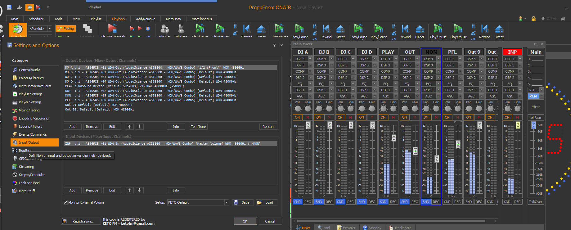

Hello

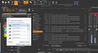

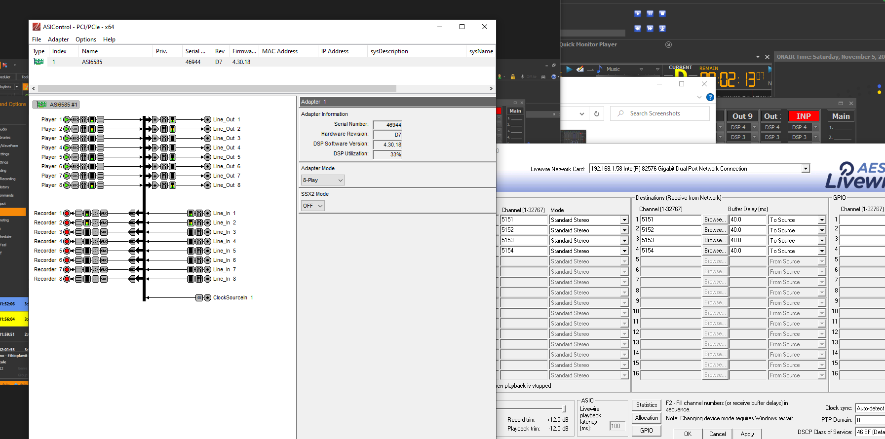

I have Axia Livewire with total 12 in and out Livewire soundcard
my PC and Axia is coenacted with RJ45 Livewire
I need 4 players that I can output each to a different Axia Livewire fader of my mixer. I have 14 faders
So, Player DJ A outputs channel 1 - ASI6585 /01 WDM Out of my Axia Livewire soundcard to fader 1 of my mixer, so on...
Player DJ A outputs channel 1 - ASI6585 /01 WDM Out of my Axia Livewire soundcard to fader Axia 1 of my mixer,
Player DJ B outputs channel 2 - ASI6585 /02 WDM Out of my Axia Livewire soundcard to fader Axia 2 of my mixer,
Player DJ C outputs channel 3 - ASI6585 /03 WDM Out of my Axia Livewire soundcard to fader Axia 3 of my mixer,
Player DJ D outputs channel 4 - ASI6585 /04 WDM Out of my Axia Livewire soundcard to fader Axia 4 of my mixer,
Player A outputs channel 5 - ASI6585 /05 WDM Out of my Axia Livewire soundcard to fader 5 of my mixer,
I reed to know how i can rout all DJA DJB DJ DJD and Cardwall I and II MOM
Routing:
DJ Player A -> output PLAY
DJ Player B -> output PLAY
DJ Player C -> output PLAY
DJ Player D -> output PLAY
Standby -> output OUT2
PFL Player -> output outputs channel 6 - ASI6585 OUT6
Quick Monitor -> outputs channel 7 - ASI6585 OUT7
Cardwall I -> -> output OUT8
Cardwall II -> -> output OUT8
I cannot find the correct settings in the configuration to do this.
Can someone show me how to setup this?

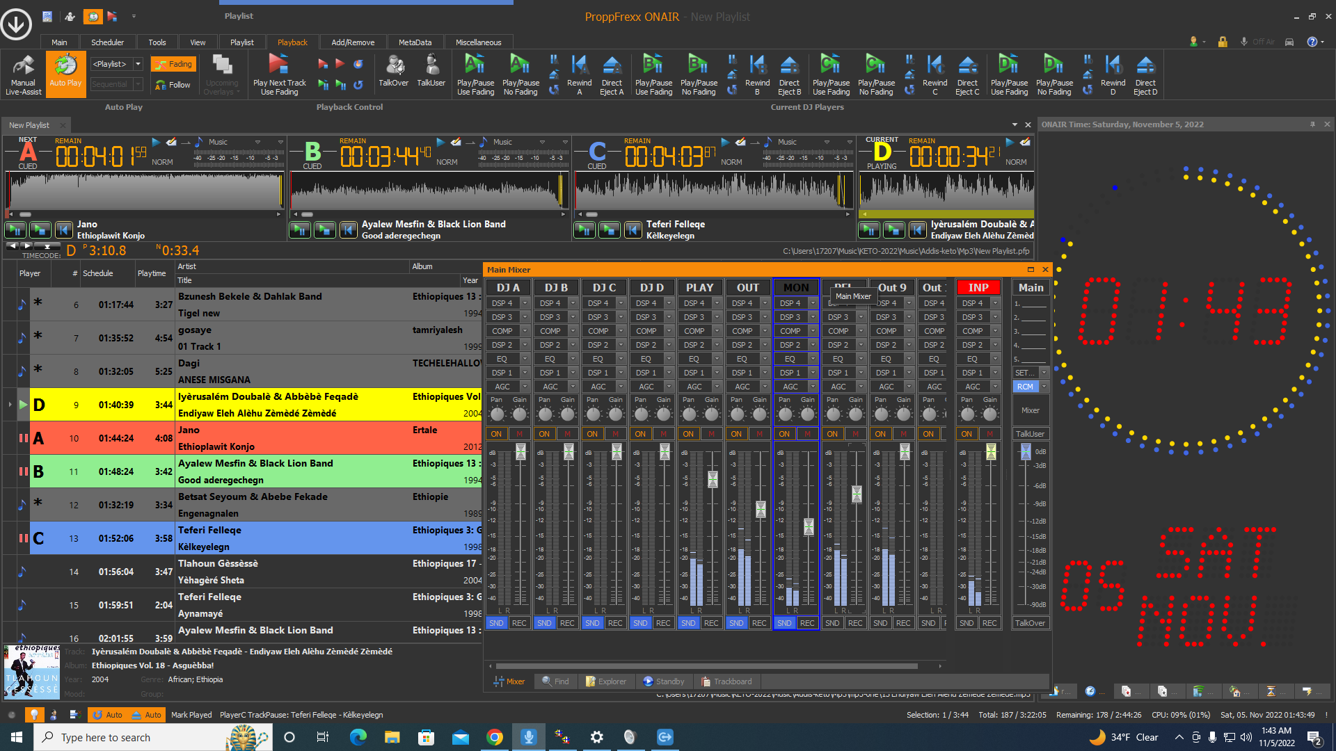

ketofm
Posts: 75
Joined: 05 Jul 2020 11:48
Re: configure output per player
Post by ketofm »

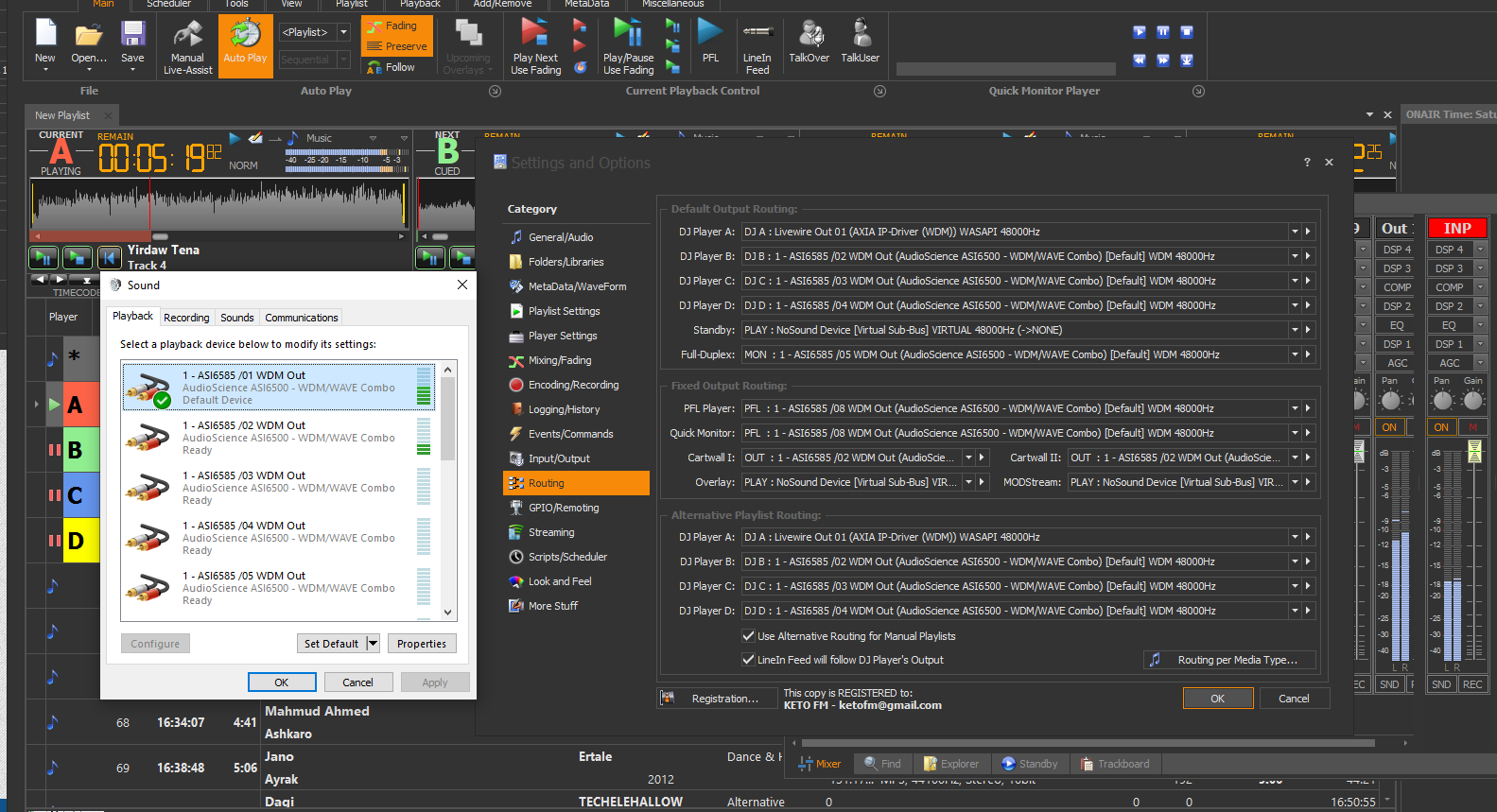

More pic

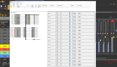

ketofm
Posts: 75
Post by ketofm »

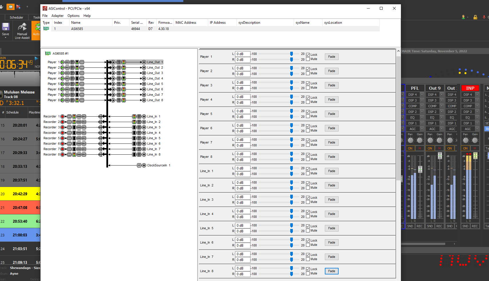

8 in and 8 out Livewire soundcard

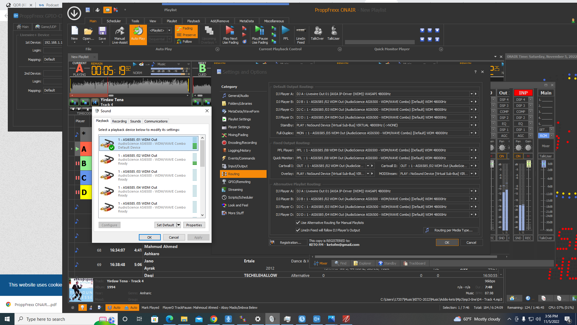

Posts: 9138
Can you explain what is not clear to you resp. where you need help? Did you read and understand the info 3 posts above?
First it seems you should deactivate the Alternative Routing option (check box) as you probably don’t need it (or why have you checked it?)
Same with the LineIn Follow checkbox.
The routing of the DJ Players seems to look good. Ie. you have assigned them each to an individual output mixer channel of ProppFrexx.
So these should work fine - correct?!
But the rest of the ProppFrexx players, ie. the PFL, Standby, Cartwall Players. On which output should they be played?
You simply need to define, what ProppFrexx Player should go to which ProppFrexx output mixer channel.
And finally you connect each ProppFrexx output mixer channel to an available physical output. Ie. to your Axia device.
P.S.: Modern Windows OS only use WASAPI driver modes, so choose these in your output configuration.
So I assume you can remove the PLAY virtual output mixer channel; create one mixer output channel for Standby, Cartwall I, Cartwall II…
But maybe you want all other player to the same output?

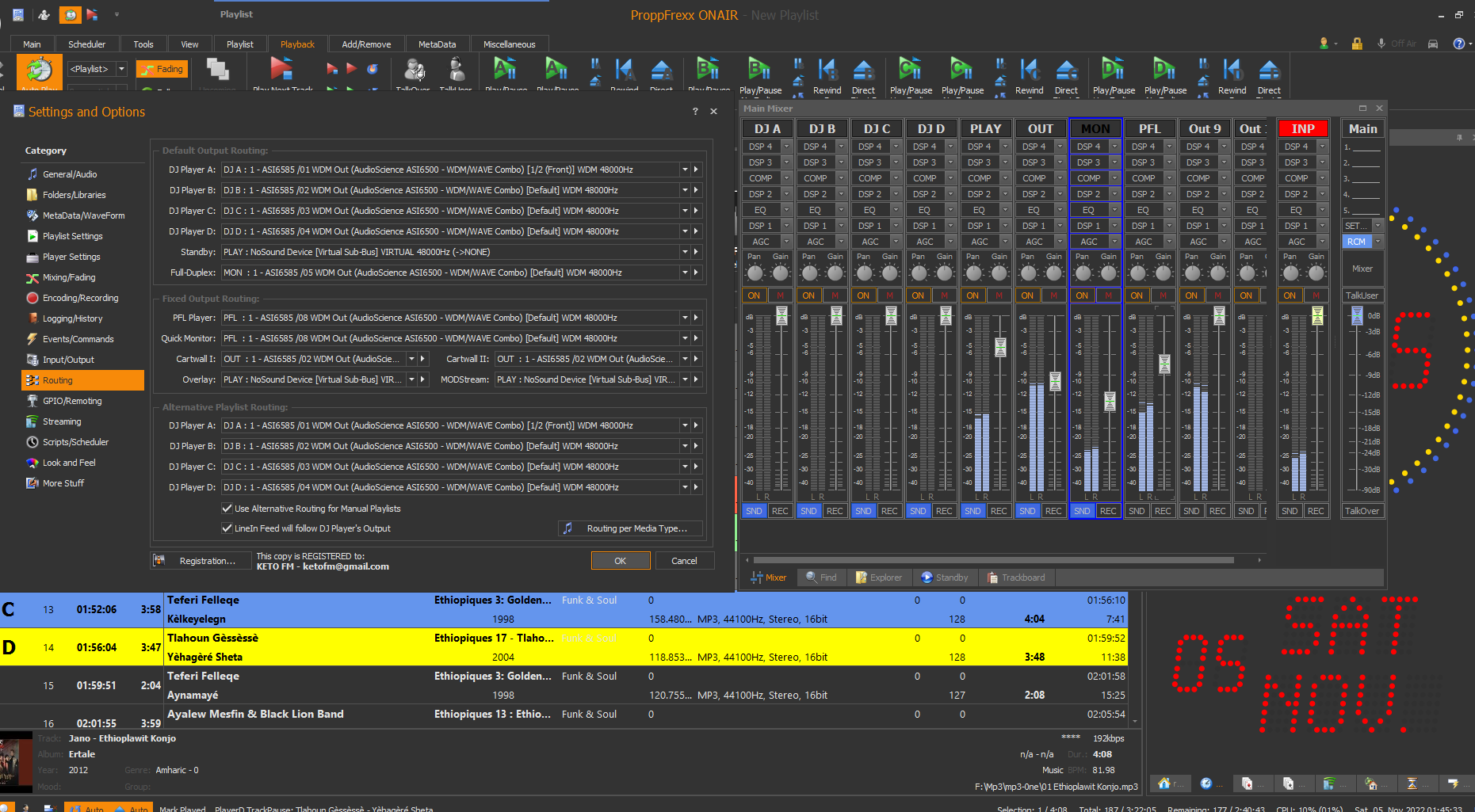

ketofm
Posts: 75
Post by ketofm »
Yes, I read your explanation on 3 posts above, vary helpful thank you
I did it but its not paling in DJA, DJB, DJC, and DJD each physical Output soundcard faders....output each to a different Axia Livewire fader of my Axia mixer.
When DJA player is NOT paling on ONLY DJA player fader, is paling in ALL faders 2, 3, and 4 on Axia Livewire fader mixer,
i can hear it on ALL faders,,
i only want it on each physical Output soundcard faders on my Axia Livewire fader 1 soundcard for DJA player, fader 2 soundcard for DJB, fader soundcard 3 for DJB, fader soundcard 4 for DJD player ONLY i need
and i like to hear it on MON CUE fader too on my Axia Livewire fader 11 and 12 on mixer
But, i need to send all the player to each faders that's what i real need help with right now, than i need help on GPIO when all the Axia Livewire with total 12 in and out Livewire soundcard setup complete
But, first i real need help on how to send each DJA DJB, DJC, DJD to each different livewires fader soundcard

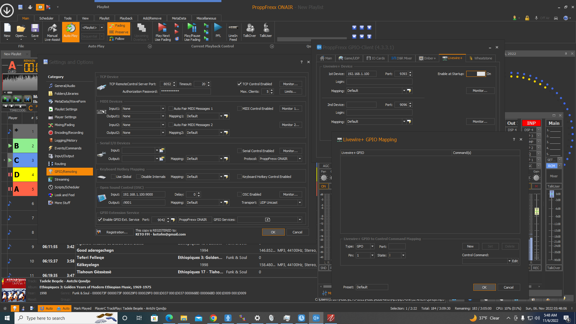

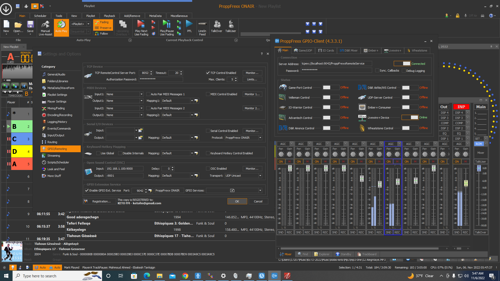

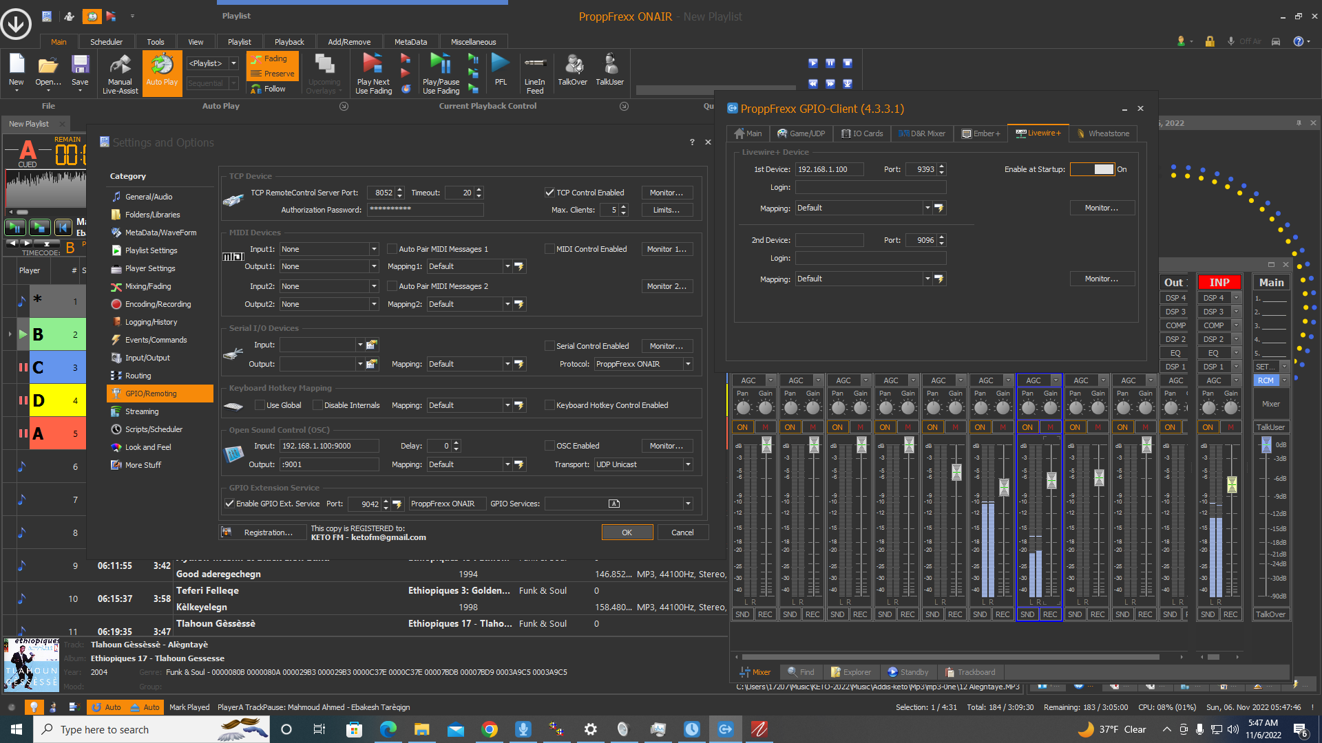

GPIO
GPIO
GPIO2
GPIO2
GPIO3
GPIO3
