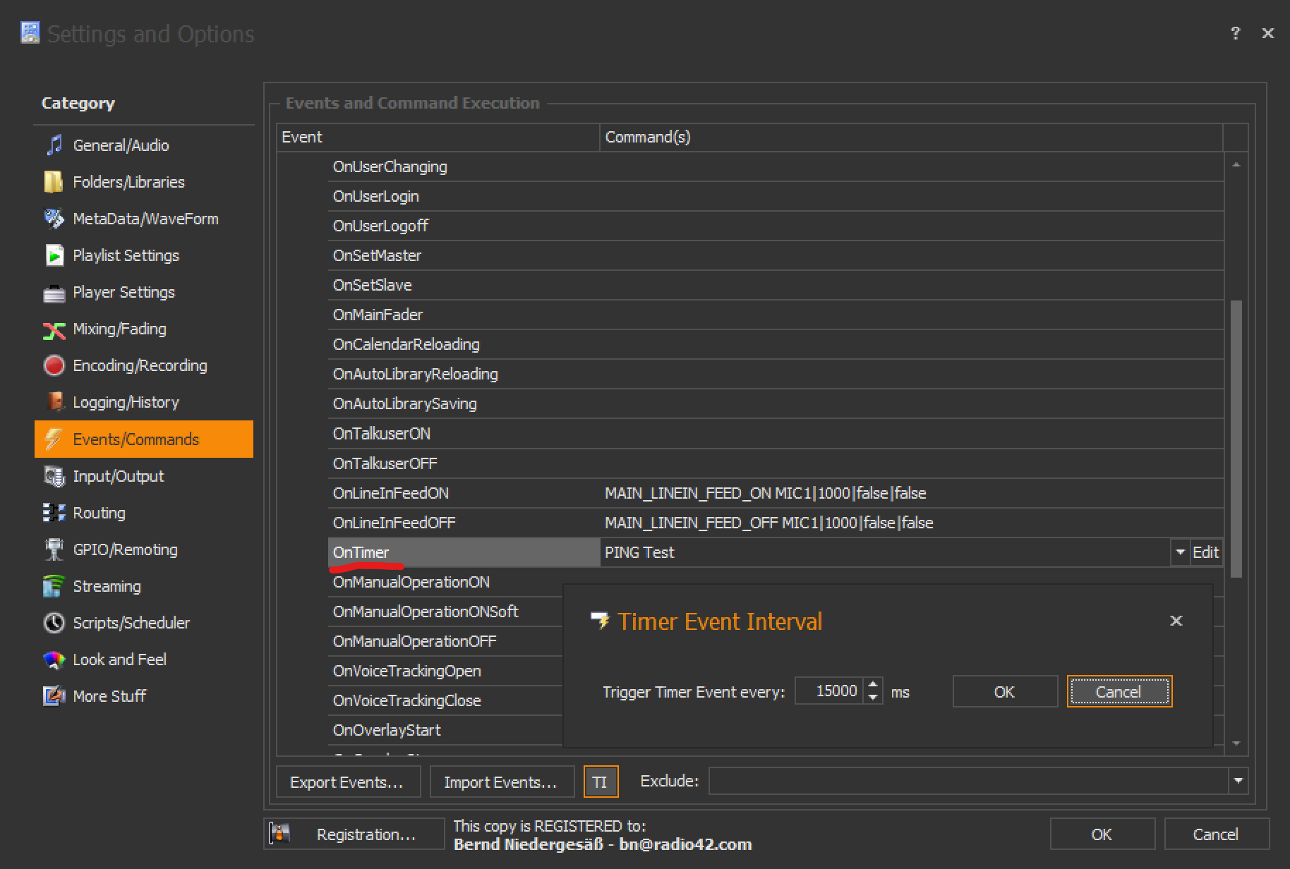

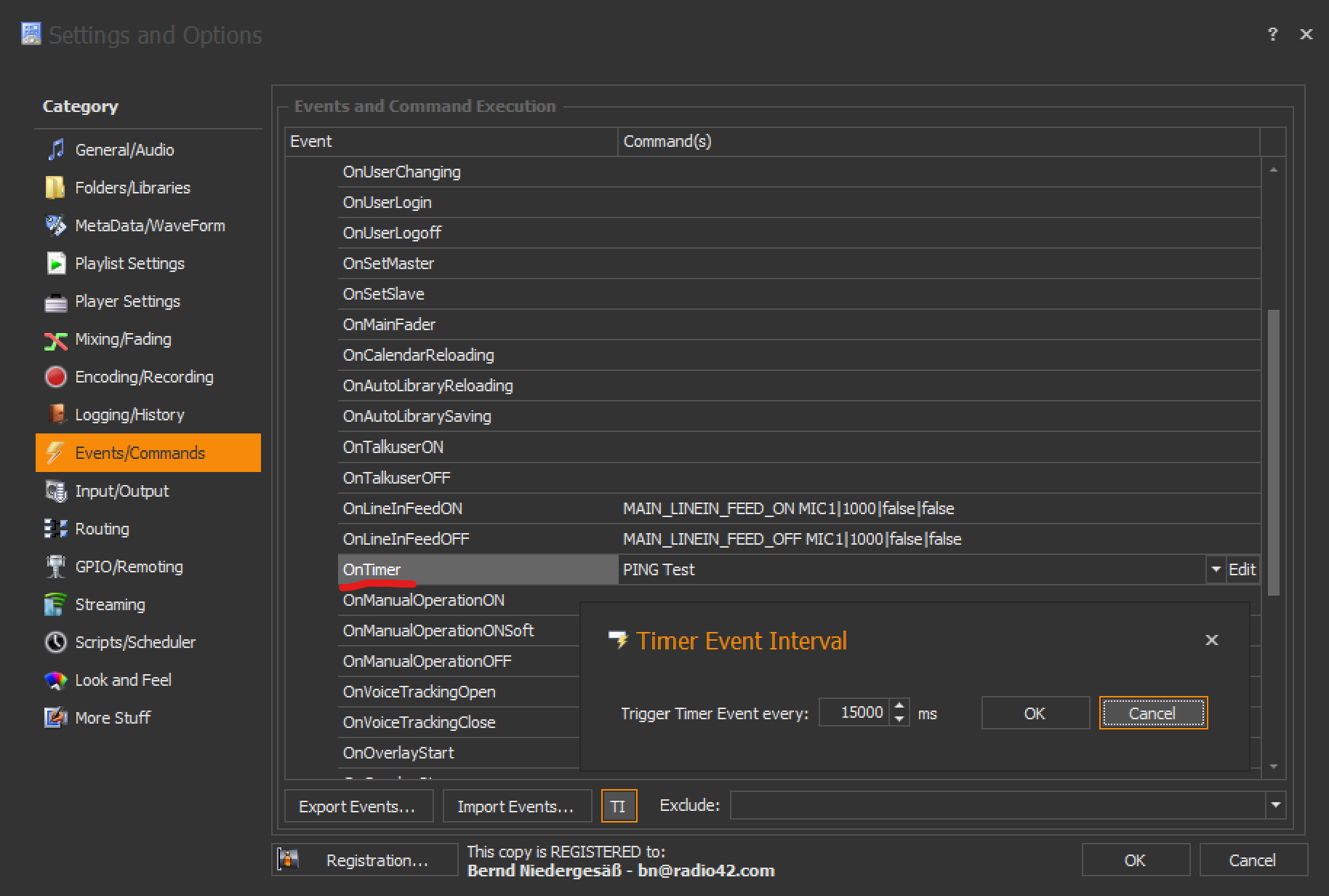

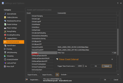

I can see the timer. Could you possibly give an example of how this might work with a command?
Re: Repeating TCP/IP commands
When you click on the TI button you can set a time interval to raise the "Application.OnTimer" event - e.g. set this to 15000 ms for every 15 sec.
In the Application.OnTimer event you can now specify the command to execute every 15 sec. (note, that global macros can be used here).
In the example below the command "PING Test" is being send.

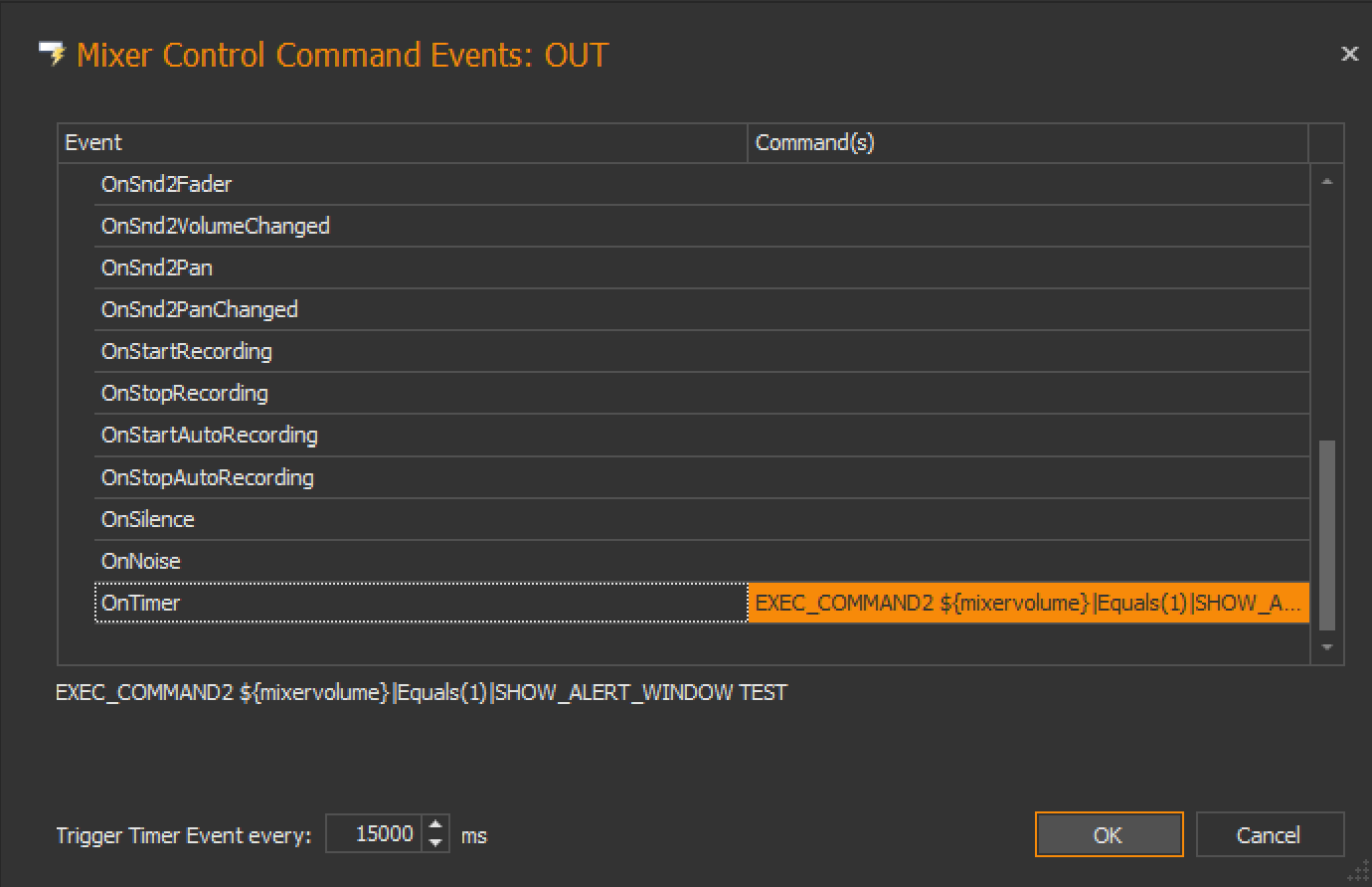

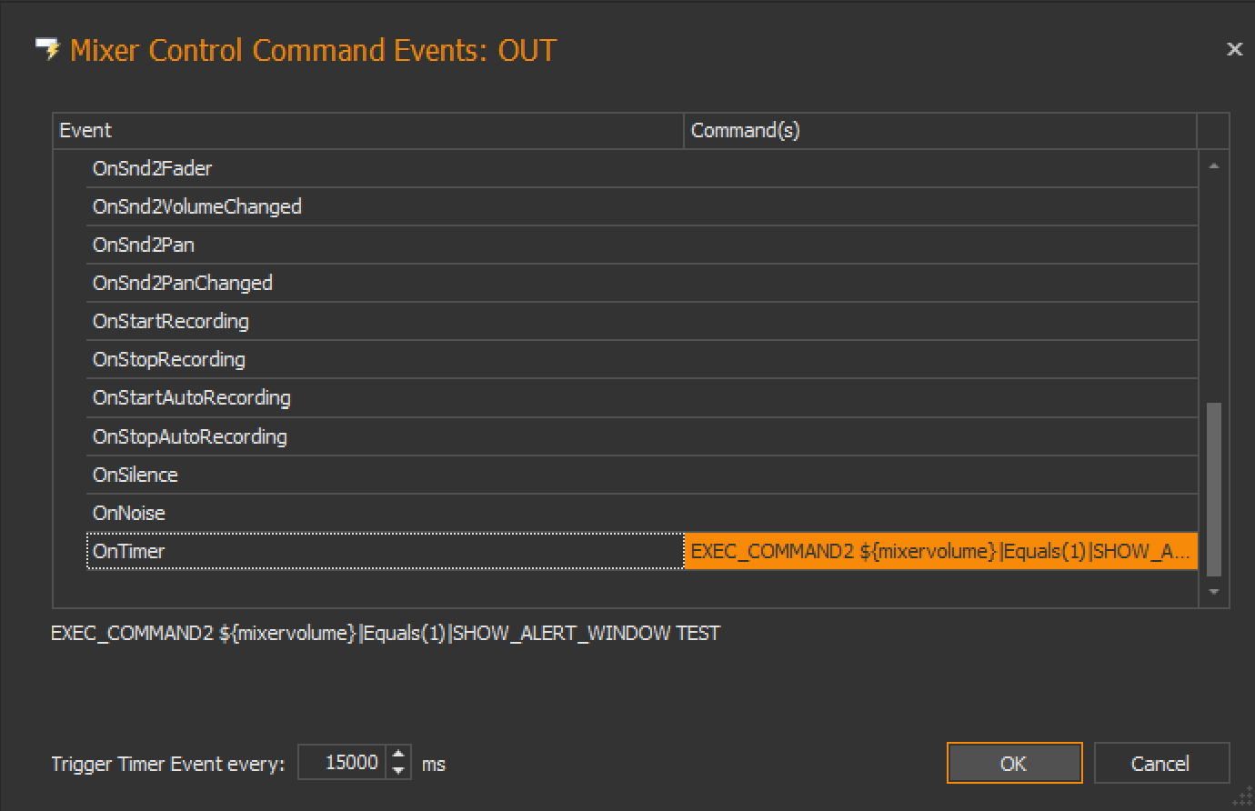

Ok, so I wonder if the timer event could be used to trigger a command to evaluate a parameter and result in an action?
Something like IF MIXER_INPUT_VOLUME_GET=1, EXEC_SEND_TCP?
Conditional command-execution can be performed with the EXEC_COMMAND2 command. See the user manual appendix for details.
Conditional commands use macros to evaluate a condition.
There is currently no explicit macro for getting a specific mixer volume (note, that your example is lacking a mixer name)...
BUT there is a specific mixer event for this existing: make a right-click on a mixer name and select 'Edit Control-Command Event...'
In this dialog you also have an OnTimer event and this executes on the specific mixer channel, e.g. you can use all mixer related macros!, like the ${mixervolume} - See the user manual appendix for further mixer macros.
E.g. here you could specify the following;
EXEC_COMMAND2 ${mixervolume}|Equals(1)|SHOW_ALERT_WINDOW TEST
You'll see, it only executes, if this mixer channels volume is fully up (i.e. = 1).
Replace the SHOW_ALERT_WINDOW TEST command with your TCP call, as needed...
