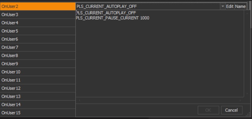

We tried the following command:
as a result, after 1000ms, the current track was paused, and the next track automatically played, although, according to the idea, we turned off autoplay and paused.
Perhaps somewhere we can set up automatic playback at another level?

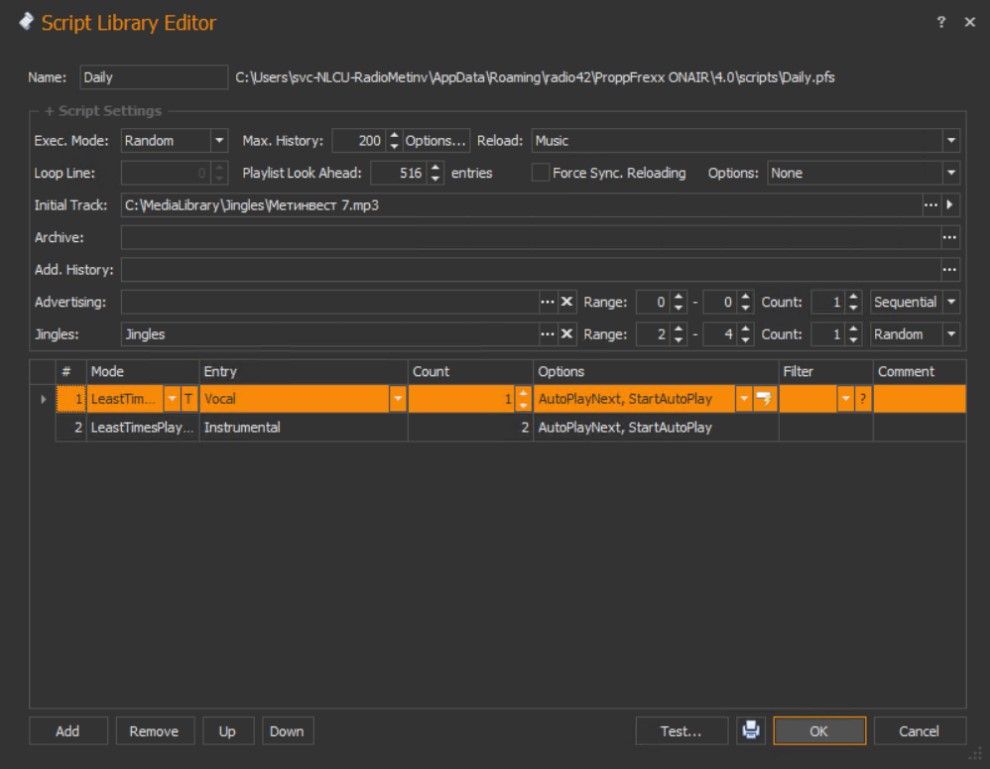

Here is another topic on this forum where you helped me to insert jingles. Perhaps the settings described there are somehow related to the problem that the commands do not work out as they should. After all, with the standard configuration of the ether, the commands work as they should.
For jingles, this setting is used, it seems that the autoplay that is used when an alarm is triggered is related to these settings:
Posts: 9160
Re: Automatic air alert
Yes, this is almost exactly what I meant above.
In your script, you have explitily set the for the script-lines the options: AutoPlayNext and StartAutoPlay.
These options should be removed, as else, the global AutoPlay setting (the AutoPlay button in the ribbon toolbar) is always overruled. Why have you even set it here? I don't see any reason for it.
I.e. when you have set the global AutoPlay setting, then a next track is automatically played. When AutoPlay is deactivated, this does not happen - this is also what we use for the Alert.
But with your two options, you always turn it back on - so please remove these options from your script-line.
