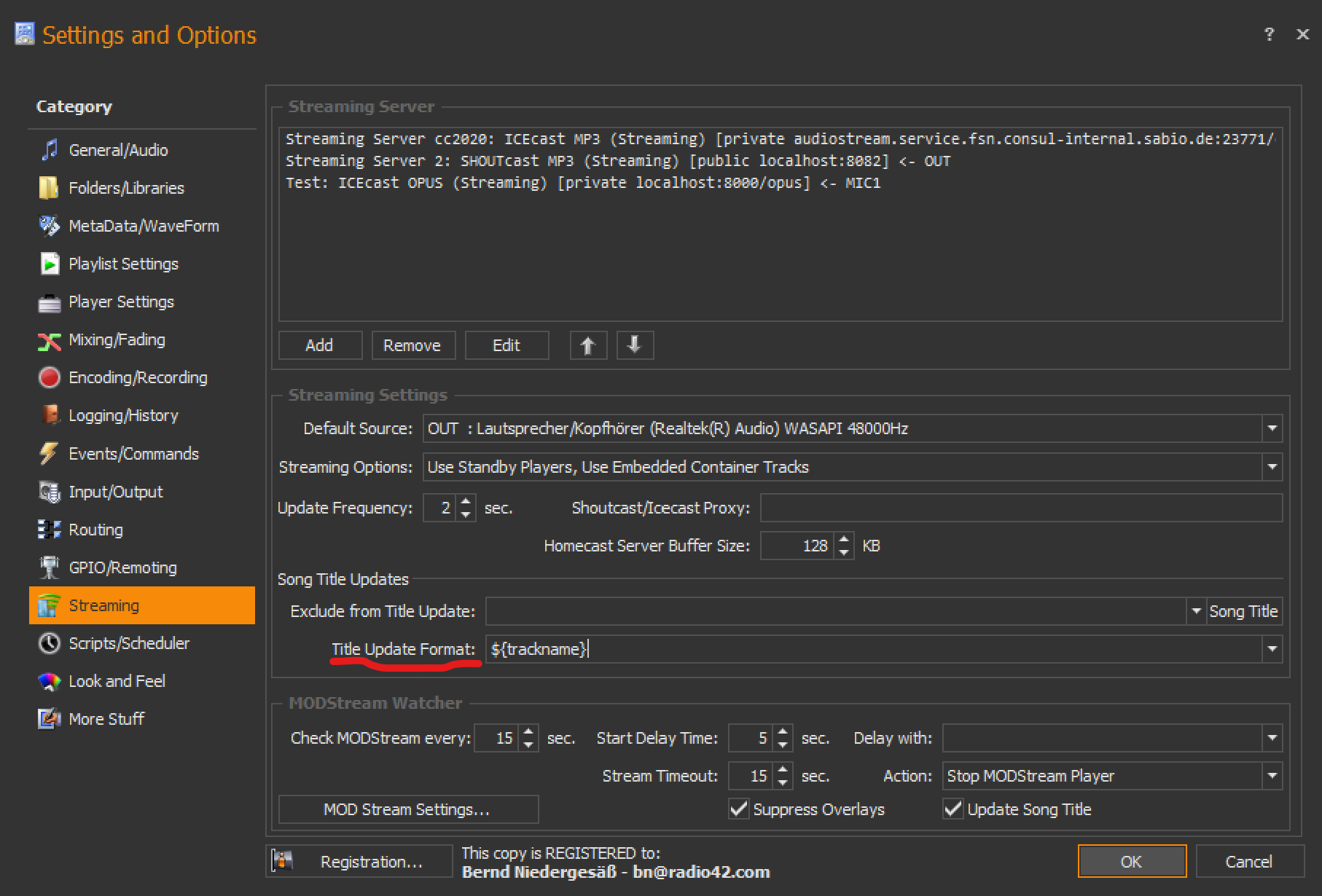

When you set the Streaming Title Update Format to "${trackname}" you can tag the jingle or advert audio track with e.g. an empty Artist, but only set the Title to "Advert:":

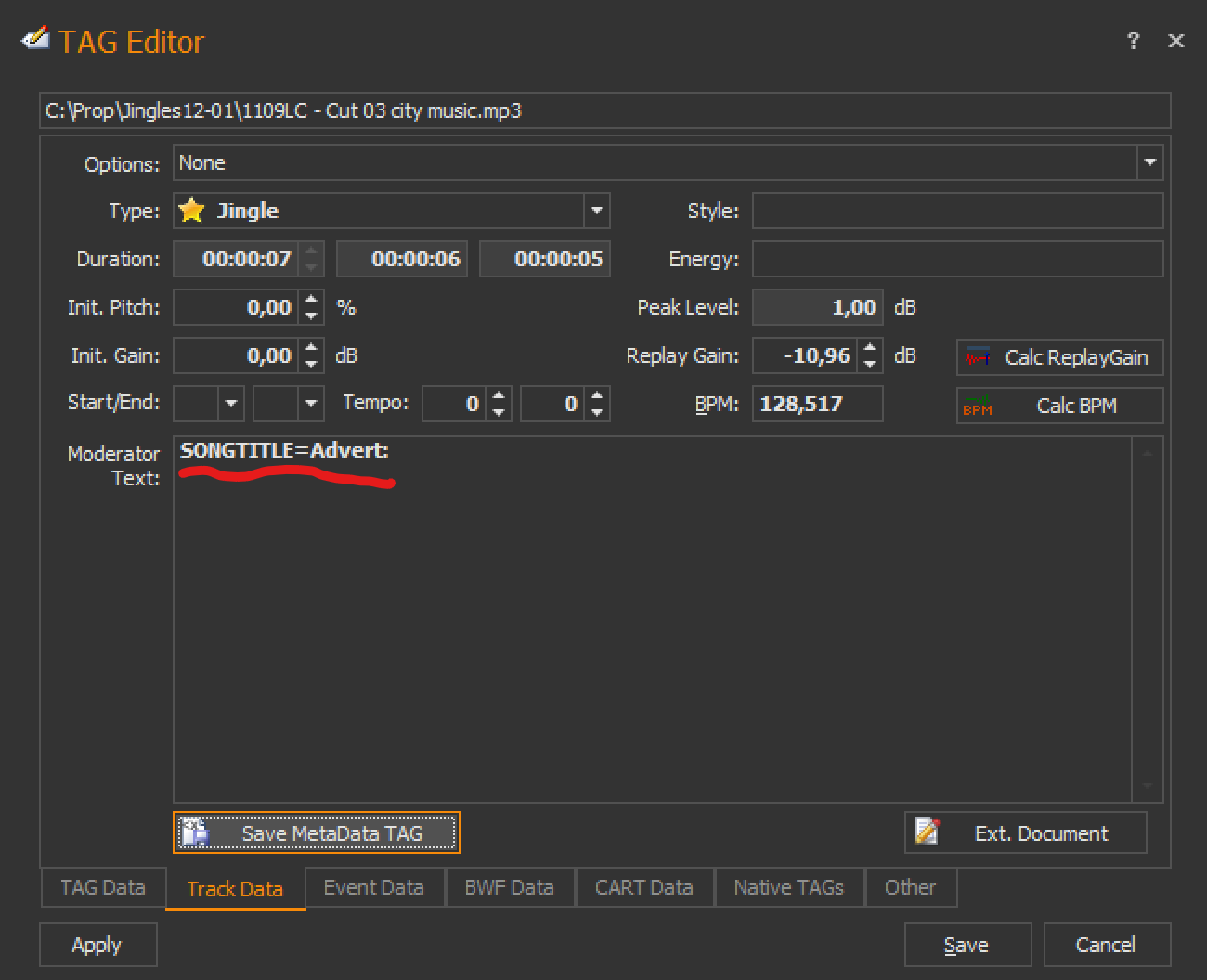

Alternatively you can set a special value to the Moderator Text in the meta data (TAG Editor) to overwrite any meta data, but directly set the song title.
"SONGTITLE=Advert:"

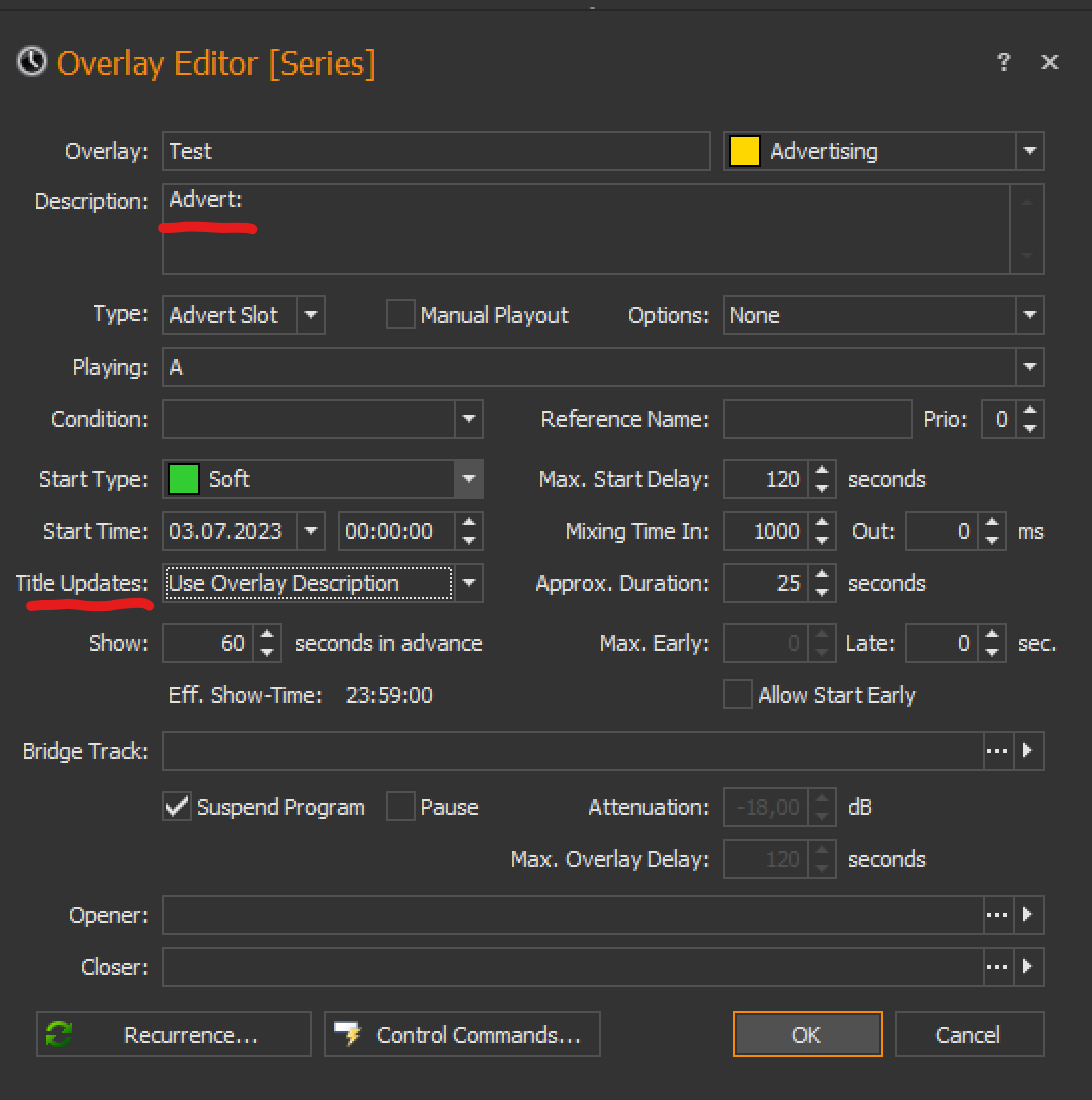

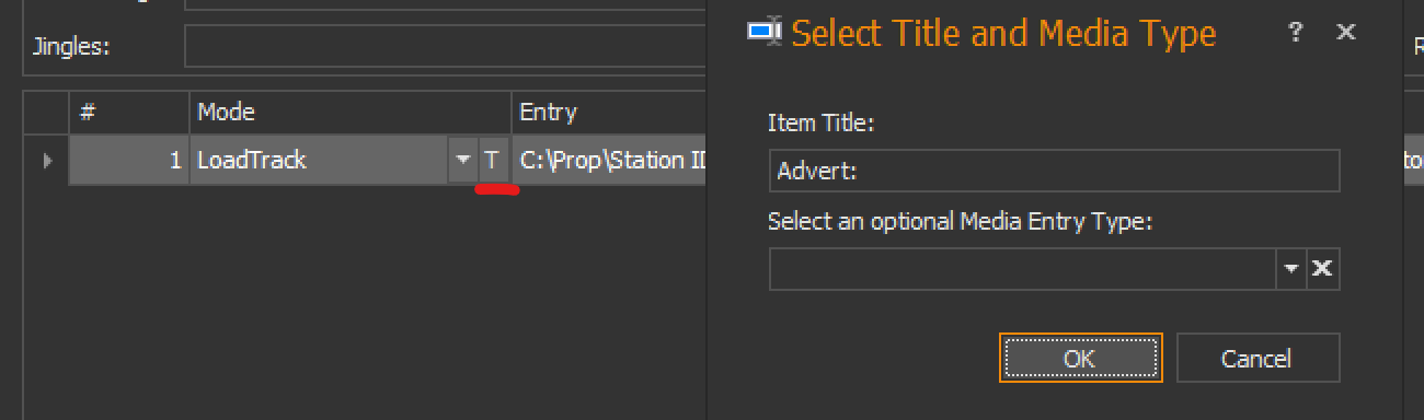

Within a script (resp. script-line) you can also explicitly set the song title by clicking on the "T" button:
Within an overlay you can define what song tile should be used within that overlay. E.g. you can set the song title by only using the overlay description as the song title:
By doing so, you can set any song title update exactly as required by the target system's ad stitching.
"SONGTITLE=Advert:"
