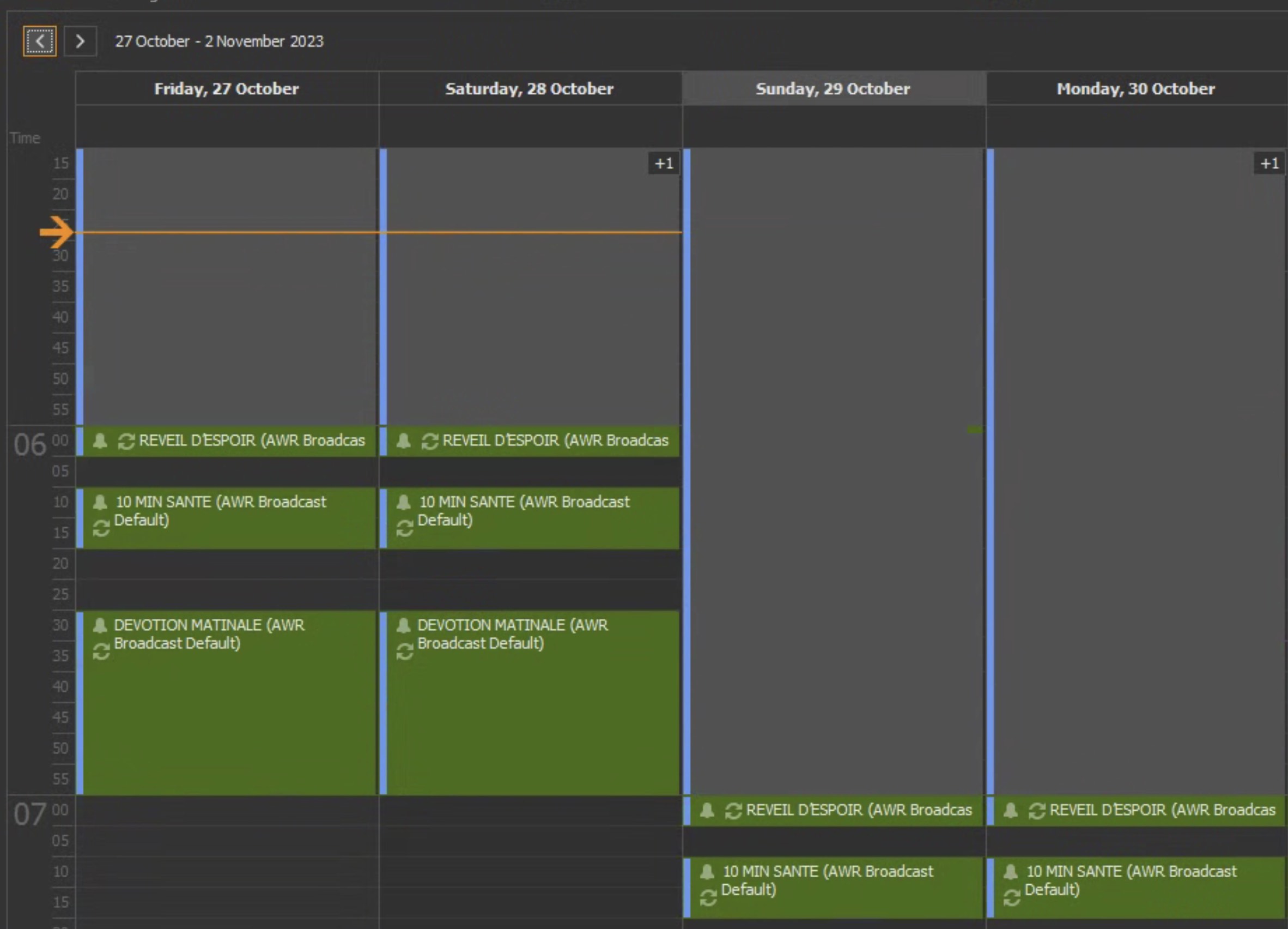

I've noticed an issue with the clocks going back this morning with our new station that's now operating in a country that does not observe DST and all scheduling has jumped forward 1 hour. How do I disable DST in ProppFrexx for countries that don't observe DST or force it to follow system region settings?

ProppFrexx is using the PCs internal clock (ie. the one of the Windows OS).
As such, you need to adjust your Windows clock settings accordingly. Please consult your system administrator, or see here:

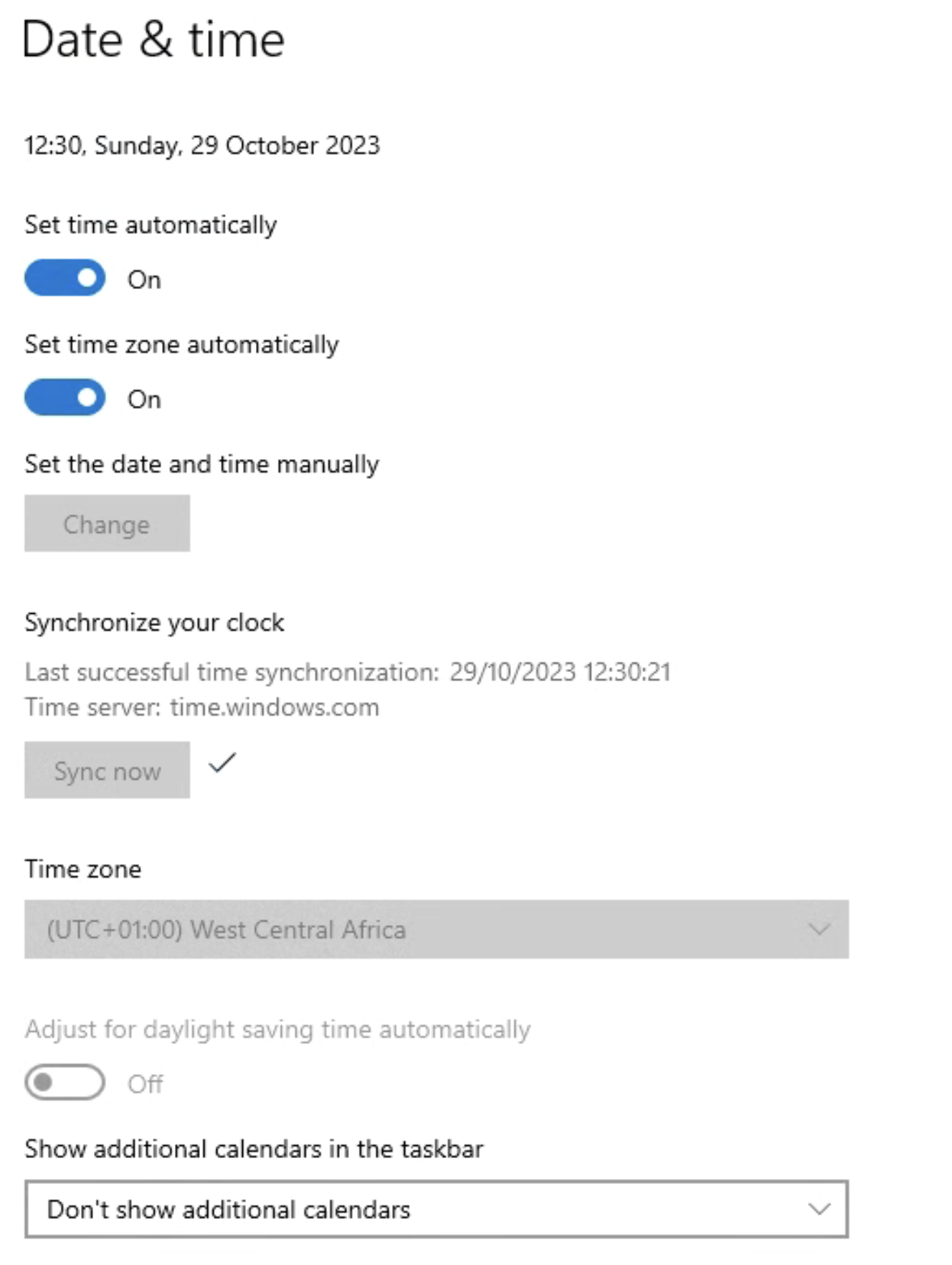

The system clock has not changed. The region and time are correct(West Africa UTC+1). Our UK stations like HopeFM set up way back in 2019, and 2020 are correct and the schedule has never been affected, as they follow DST, but this one is in a country that does not follow DST at 3am is when the issue started as if ProppFrexx adjusted the schedule for DST when the system clocks never changed. The region is correct (West Africa +1 UTC), and DST off and greyed out in windows as it's not observed in that area.
