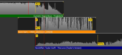

I have investigated your playlist...you have the following 3 tracks in this order:
1. File="03 Troglodyte.m4a"
Duration: 199,899 sec.
Next Cue-Point at: 187.418 sec.
-> I.e. the next song plays ~12 sec. before this track ends.
2. File="VREC_20231110_144240.wav"
Duration: 34,320 sec.
Cue-In at: 7.640 sec.
Next Cue-Point at: 7.68 sec.
-> I.e. when this track is started, almost imediately the next track (3.) is also started!
3. File="11 This Love Taylor S Version .m4a"
Duration: 250,100 sec.
-> This track starts, when the VT Track (2.) track is started
-> and as such, for about 12 sec, Track 1., 2. and 3. do all play in parallel.
Here is the Segue visualized in the ProppFrexx Segue Editor:
Sometimes this is exactly what you want (as your 2. track is a VoiceTrack).
As the Tailor Swift track (3.) has a very quite and long Intro, this doesn't even sound bad. I personally would maybe just attenuate Track 1. and 3. around the VT Track (2.) - but for the rest all is fine here.
