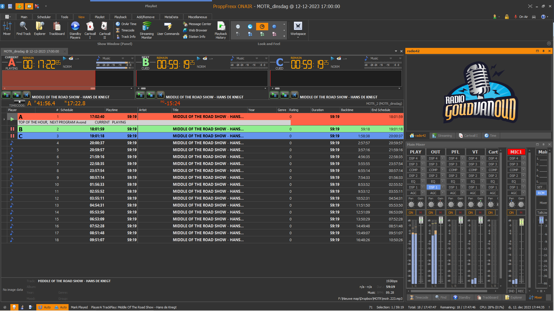

I have a daily pre-recorded program. This is 1 file that I created in Script Library. I set the loopline to 1 because it's only 1 traffic jam of an hour. This program is launched after an overlay schedular with the news. Once the playlist is loaded get a whole row with the same files. How do I change this in the schedular so that only 1 file in the playlist is opened? See screenshot.

LoopLine = 1 is the default, meaning the script loops with the 1st line.
If you only want to play the first script line once, you need to add more script-lines and set the LoopLine =2.
E.g.:
1. LoadTrack, your pre-recorded file
2. Random, Your Media Lib
3. …
E.g.:
3. …

Thanks for your quick response. It works fine as it is now, but it's more the visual aspect. Fortunately the file only plays once
. The way I see it is that only 1 line is displayed. But otherwise it's not a problem. Thanks again.

In any case, no matter how long the program effectively is, the playlist/scheduler always queues at least as many tracks as DJ Players are available.
