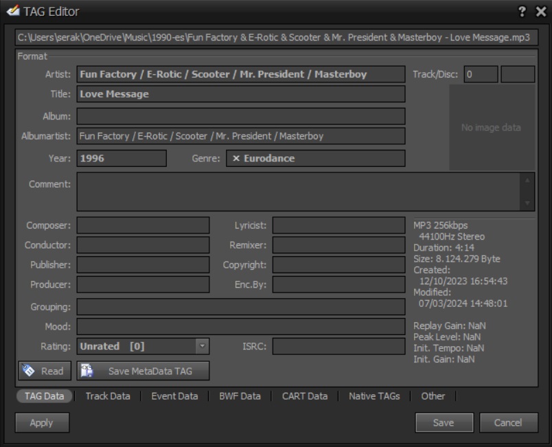

So I can use the / directly in the Metafield and Proppfrexx will recognize it as multiple artist?!

No. As I tried to explain above (maybe I was not clear):
In the User Interface of ProppFrexx you use the semicolon ";" to devide multiple artists!
In the audio files tag data this is then translated according to the format of the TAG - transparently!
Example:
In the ProppFrexx User Interface (UI) you specify:
Artist1; Artist2; Artist3
In ID3v3 this might translate to: Artist1 / Artist2 / Artist3. Other tag formats even use other separators or formats to specify multi field values.
Regardless. In ProppFrexx for ALL tag formats always use the semicolon ";" to display (and edit) multiple artists!
What might be confusing is the following (which is very specific to MP3, ID3v2):
When you enter "Artist1 / Artist2 / Artist3" within ProppFrexx as an artist; this will store that artist text as is 1:1 into ID3v2. And saves it as is.
In ID3v2, the "/" is however used as a multi field separator. So when you 're-read' the tag data of this file, it will now be shown as: "Artist1; Artist2; Artist3". This is because of the above mentioned conversion.
So here (for ID3v2) it might look, as if ProppFrexx also supports the "/" as an artist separator. But this is only true for ID3v2 tags. This would not work for other formats, e.g. mp4!
As such, always use the semicolon ";" for maximum compatibility and support for all file formats.
