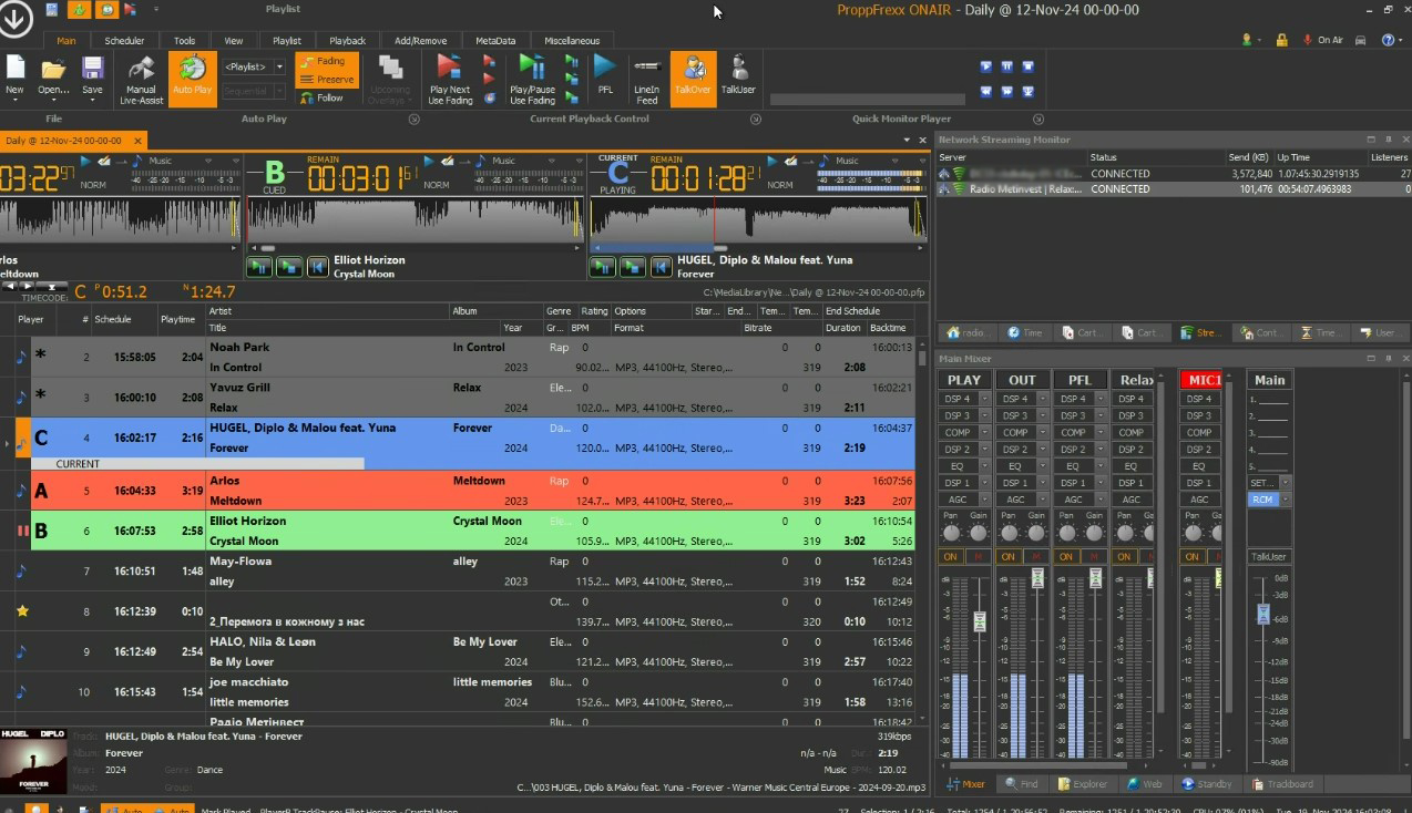

Hello Bernd, could you please help us to run the second channel (with more relaxing music)? It will be broadcasting via the same icecast server. How to run separate schedule with another content for new stream?
Posts: 9108
Re: Multiple Channels
You need to run a 2nd instance of ProppFrexx!
At best on a 2nd machine or VM.
Else you must carefully separate any configuration. Eg. Via the -globalconfig and the -config command-line option.

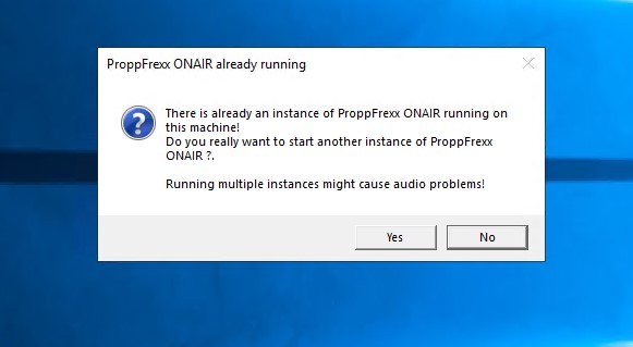

Is it possible to avoid this message before start of the 2nd instance?
Posts: 9108
Yes, see the command-line option: -allowmultiple
