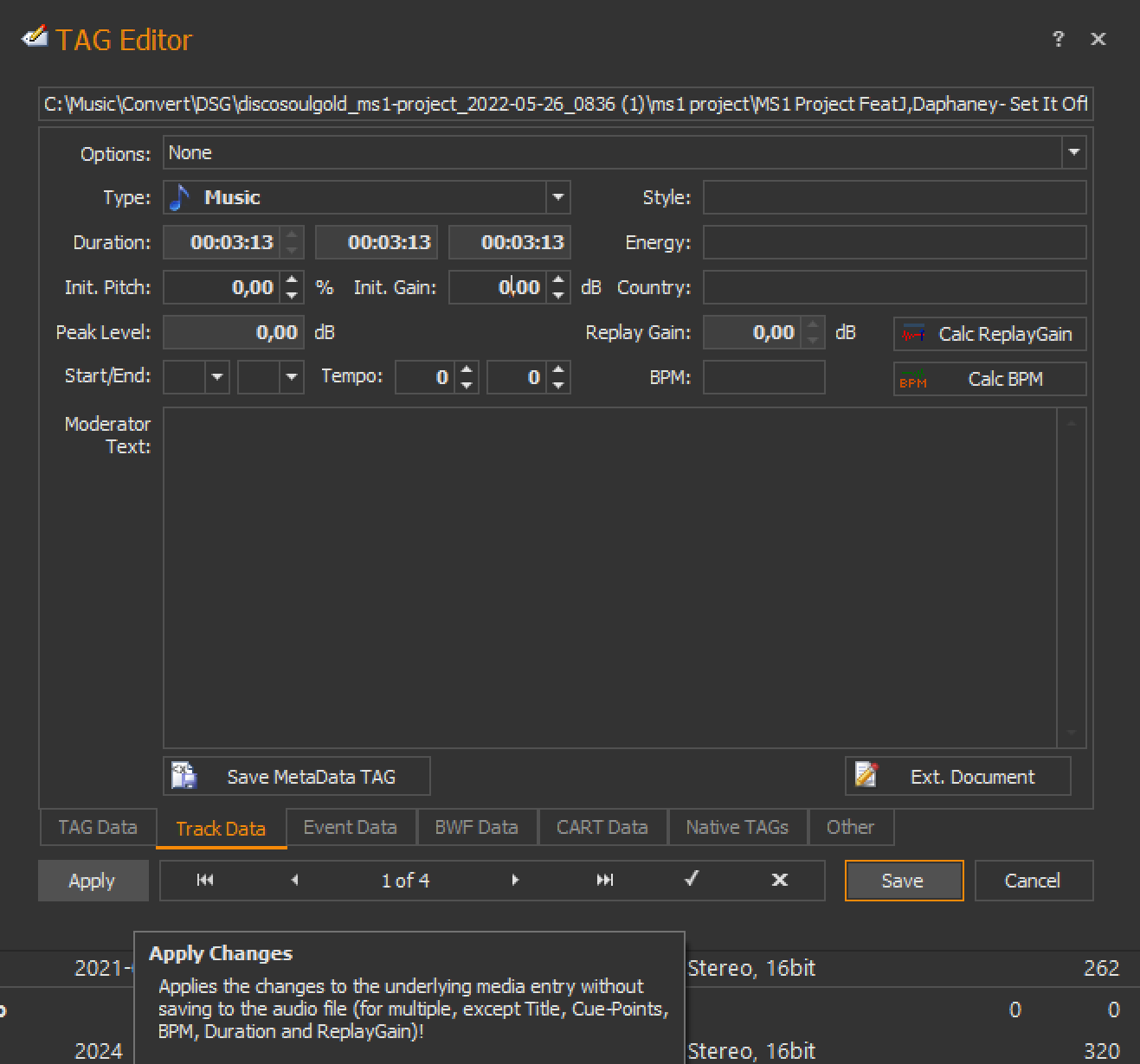

You can select multiple tracks in a playlist, then switch to the 'Track Data' tab and edit the 'Init. Gain' value to 0db and the click on the 'Apply' button (resp. hold down the CTRL-key and when clicking the 'Apply' button) - see the screenshot.
Note. that other track data might also be overwritten, e.g. the Entry Type, track Options, Start/End Indicator and Tempo,
