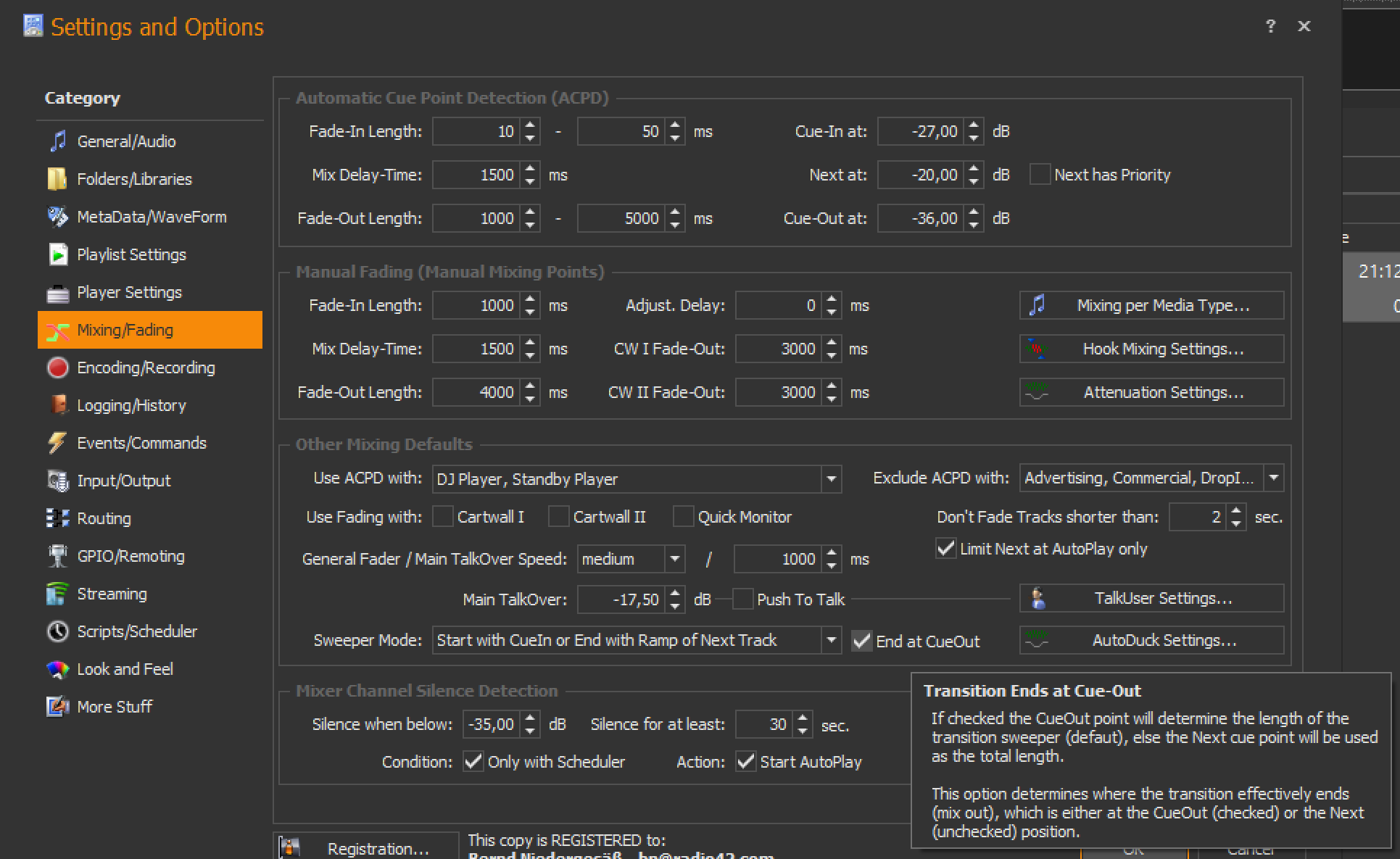

Maybe you are missing the new 'End at CueOut' transition setting - see the screenshot. As in the new version (resp. since v4.5.1.5) the effective insert duration might either use the sweepers Next or CueOut cue-point to determine its effective duration and end.
