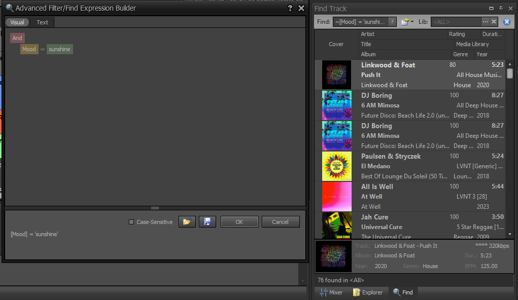

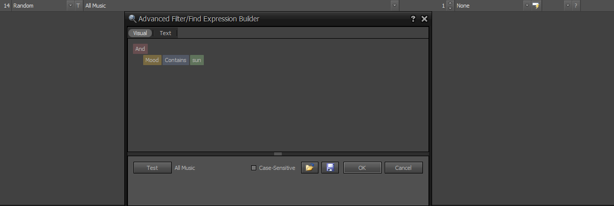

When I try to find music tagged with "sunshine" in the mood tag I get a set of results (find window.png) but when I try to perform the same search by including it as a script line I immediately do not get any results at all (find script line.png) . I am searching a very large folder with over 200k tracks. Is that the issue? There's no time delay so I don't believe the library size is an issue but when I 'test' the script line nothing is returned.
I can't figure out what I'm doing wrong?
Any suggestions?

In the Find Window the search is using all available media libraries.
Whereas the Filtern in the script is using (only) the media library as defined in that script-line (in your case ‚All Music‘).
You can also limit the search in the Find Window to a particular media library with the top right combobox.
As you also output the media library from the entry in the Find Window, you’ll see, that those found entries are from different media libraries, eg. ‚LVNT 3‘ or ‚5 Star Reggae‘ - but none from the lib ‚All Music‘.
As such, I must assume, that even if the name of the media library is called ‚All Music‘, it doesn’t contain all your music.
