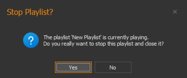

2. Dialog: Confirm, that you want to stop the currectly playling playlist - YES
Screenshot 2025-10-30 160646.png (11.1 KiB) Viewed 31216 times

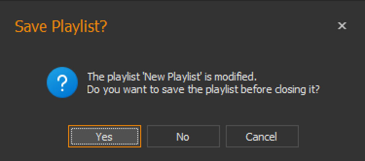

3. Dialog: Confirm, that you want to save the playlist - YES or NO
Screenshot 2025-10-30 160659.png (11.25 KiB) Viewed 31216 times
