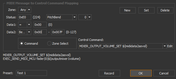

We have invested in a Behringer X Touch Compact to control it.
The Behringer works with Mackie Control.
In the MIDI device, we set the console to Input/Output.
We are looking at the manual for version 4.0, but we are using version 4.5.2.4, so obviously...

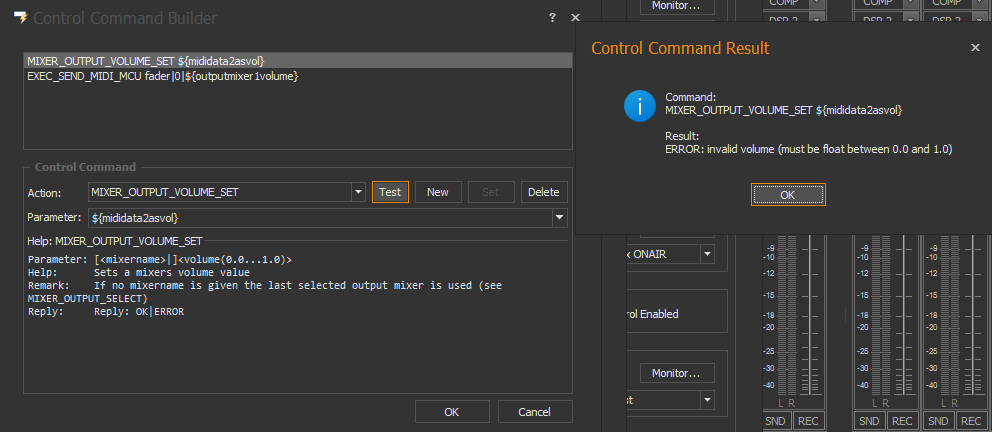

So after trying the different lines and attempting MIDI mapping :
MIXER_OUTPUT_VOLUME_SET DJ A|${mididata2asvol}
I test also :
MIXER_OUTPUT_SELECT_1
EXEC_SEND_MIDI_MCU fader|0|${outputmixer1volume}
MIXER_OUTPUT_VOLUME_SET ${mididata2}
We haven't found a model for configuring DJ A to C in MIXER_OUTPUT_VOLUME_SET, as it returns an error saying that the value must be between 0 and 1.
DJ A to DJ C, FADER 1 to 3.
But the manual indicates this command.
So for MIXER_INPUT_VOLUME_SET, it's the same problem for IN 1 to IN 5 with the FADER 4 to 8
MAIN TO FADER 9
Thank you for clarifying this and giving us some pointers.
