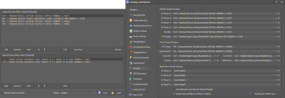

The setup of of the demo PF, for the issue reproduction, is just the default setup. I didn't changed anything.

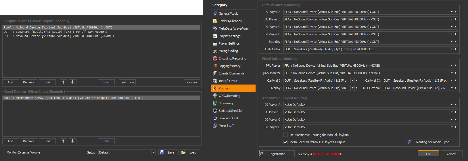

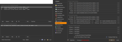

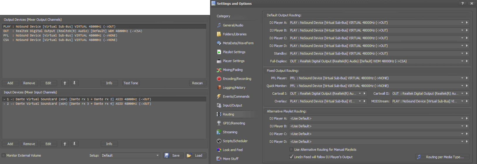

And in our studio, the routing settings are the defaults ones.
We just have two inputs (one for each live production studio). Studios are used as input in PF, we didn't use PF playlists etc for live productions.
And one output (the OUT). CSA output is just a continuous recording for legal purposes.
So I still don't understand why, when disabling the PLAY channel, DJ players don't skip to next track and simply continue playing, while the overlay stops.
