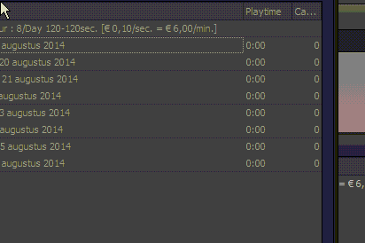

But when checking slot availability, I'm still getting nothing. (see screenshot)

- check slot availability
- propptest1.png (4.95 KiB) Viewed 8325 times
