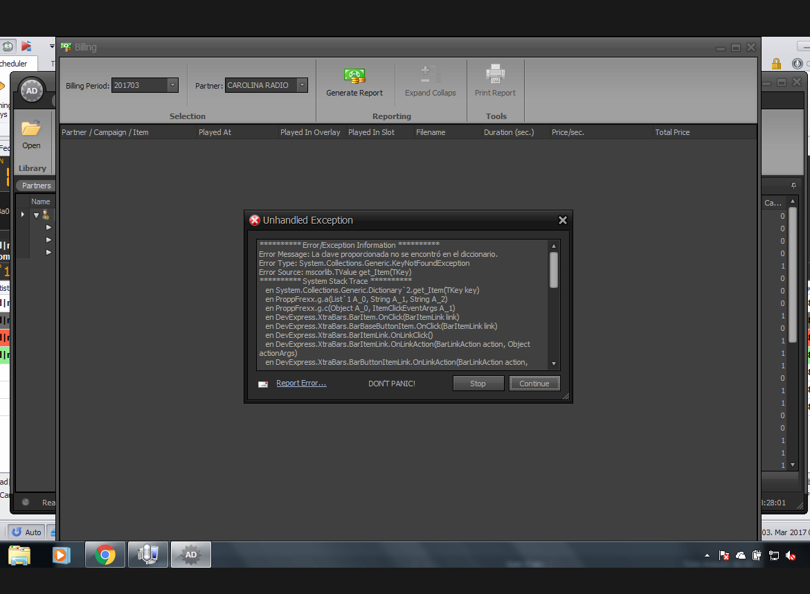

Advertising Manager Report
Post by Enriquetech »
Advertising manager give me a error when I run the billing report what this mean
Re: Working with the Advert-Manager
What exact version are you using?
And could it be, that the selected Partner doesn't exist anymore in your Advert Lib?
Or that you have already deleted some Campaigns from your Advert Lib?
You might also try the latest v4.0.3.12-beta, which adds some more checks, in case you already removed a Partner or Campaign.
