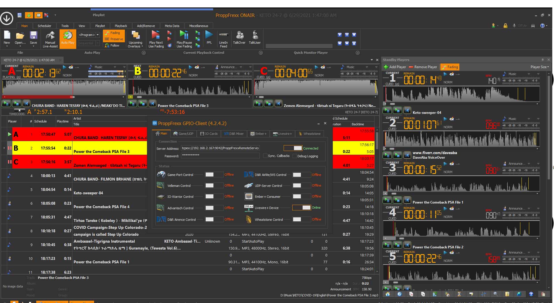

Hello
on this screenshot, how can i setup my Axia paly stop and more on Livewire GOIO?
Posts: 9141
Re: Axia Livewire GPIO to Proppfrexx faderstart
If your GPIO client is already connected, you go in that client to the Livewire tab. Here you click on the flash icon at the Mapping combobox to define the actual mapping.
A mapping defineds, what you would like to do with the incoming Livewire events. Eg. You map an incoming Livewire event to a ProppFrexx control command.
See here: viewtopic.php?f=9&t=12
Example: when you press a button or raise an event at the console (FaderStart as an example) you can map this to execute a control-command (eg. PLS_CURRENT_PLAYPAUSENOFADE_A).
All commands can be found in the appendix of the User manual.
