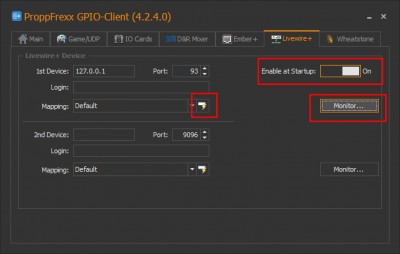

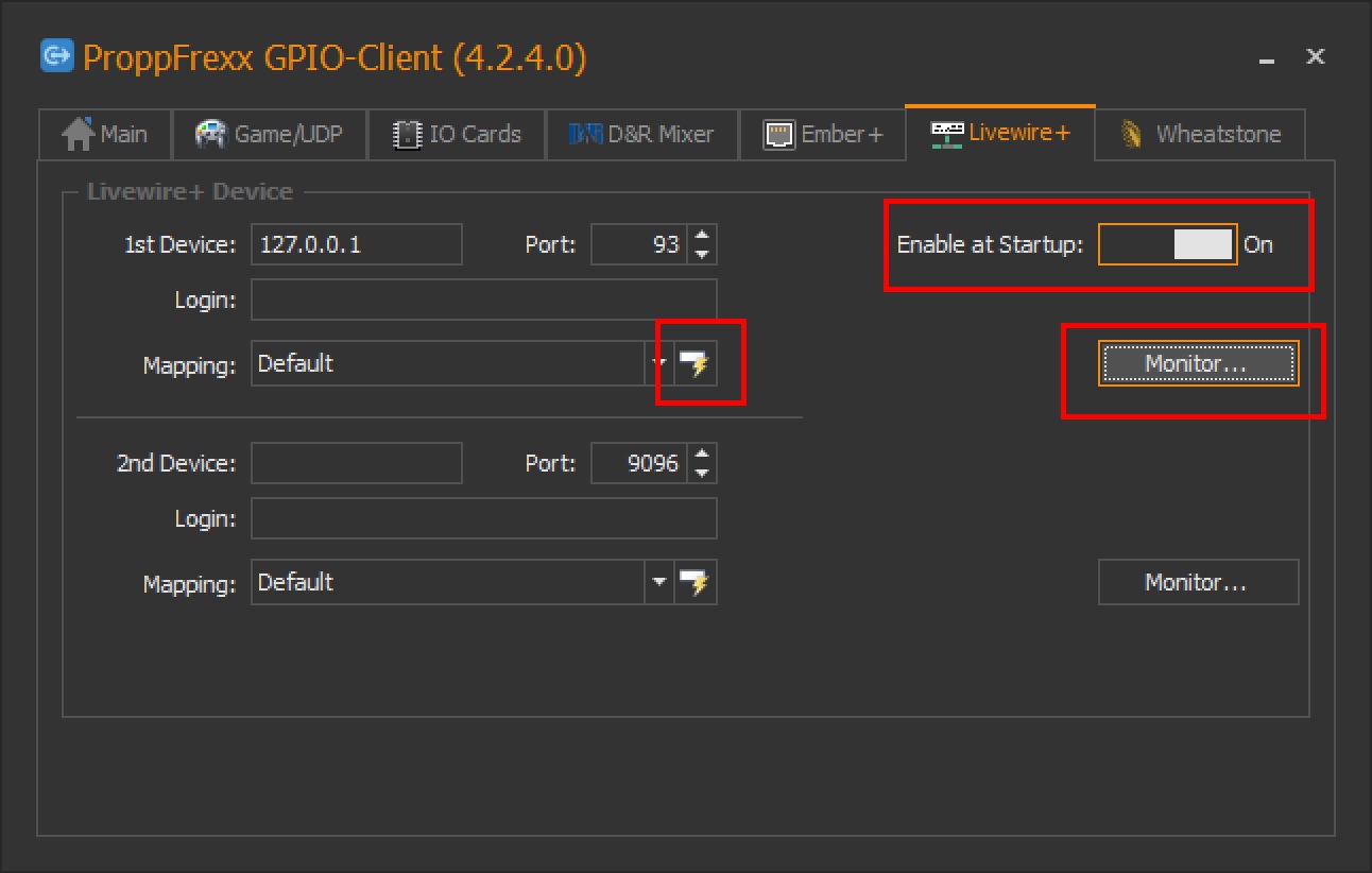

The Livewire+ protocol reacts on a pin sate change see the protocol specs for details.

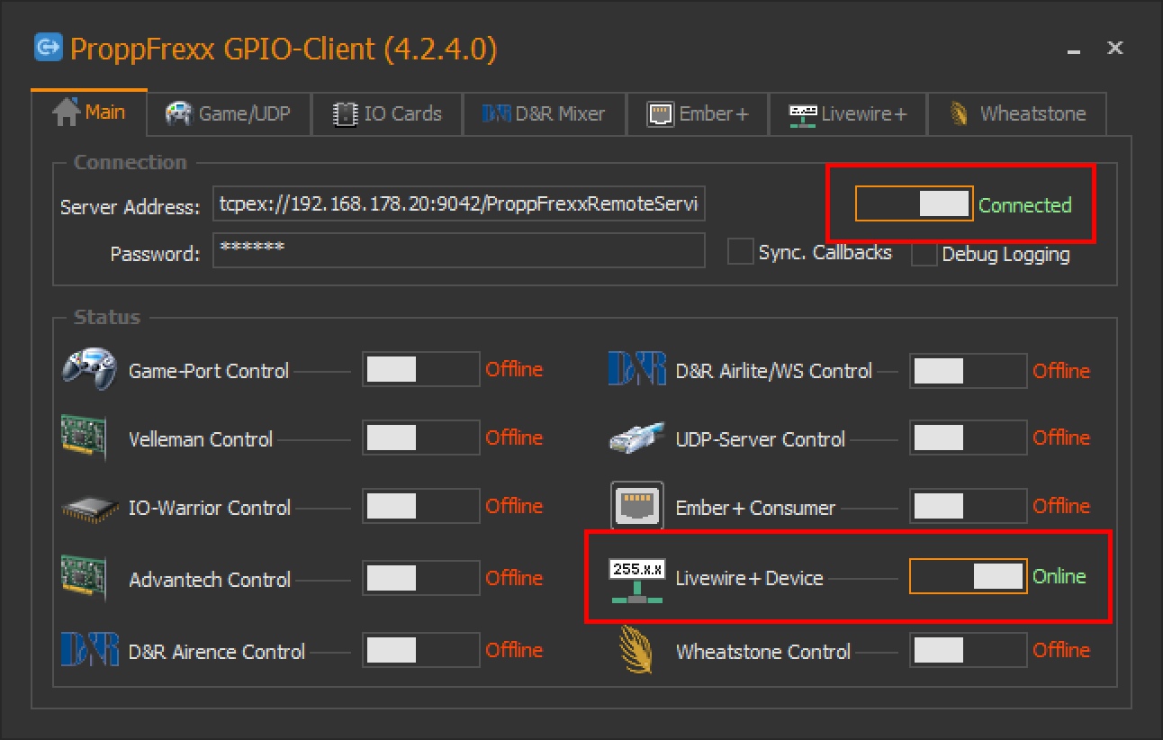

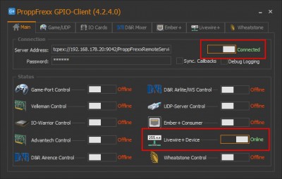

On the main screen enable the connection to ProppFrexx ONAIR and enable the "Livewire+ Device:"
When you now switch to the Livewire+ tab, you need to specify the Livewire configured Device IP address as well as the used port - see your Livewire+ device/mixer for details! If there is no propper hardware device connected to this address and port, a connection could not be established.
Once the device is connected and enabled, you might click on the 'Monitor...' button, which opens a monitor dialog to watch all incomming messages, e.g. when your console sends either a GPO or GPI pin change command.
In the mapping (click on the flash icon symbol) you can then react on such an incoming pin state change and associate any ProppFrexx control-command to it (see the User Manual Appendix for all available commands). E.g. assign PLS_CURRENT_PLAYPAUSE_A to it.
As far as I remember you must for AXIA assign a GPO/GPI to an console action first, so that this pin change message is being send - but this actually needs to be asked to your AXIA dealer.

I already had configured it exacly as in the screenshots you posted.
Next nothing is happening in "Monitor" even though I see the incoming GPO messages appearing in my telnet windows connected to 127.0.0.1:93 (which is the Axia IP-audio driver), when I turn on/off the fader/channels on the console.
