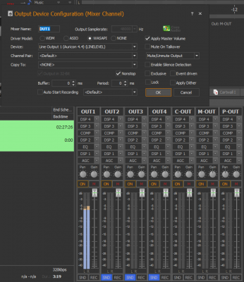

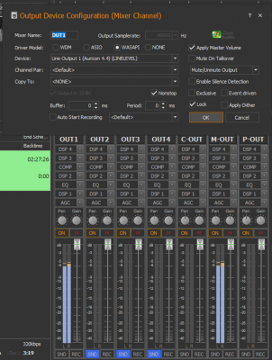

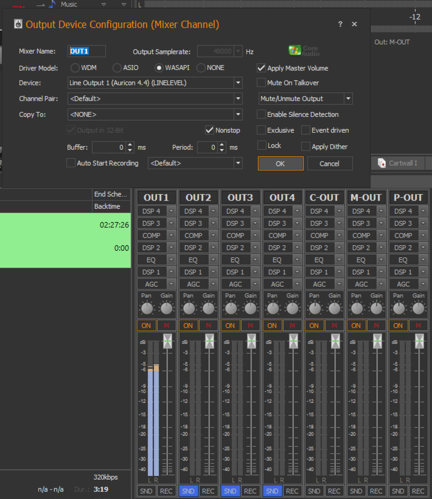

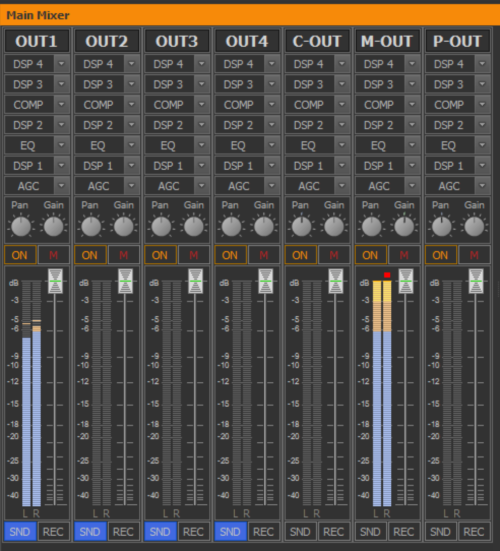

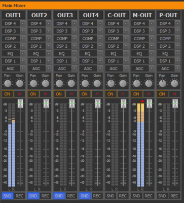

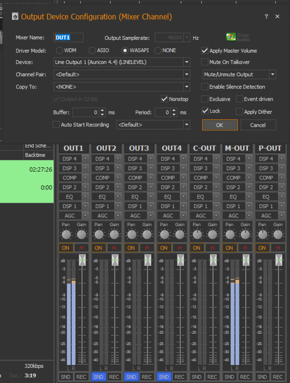

It's happened twice this evening. So I took screen shots of the different setting with SND of and SND on, etc.
Playing music from DESK A. and SND is on. you can see the volume is clipping due the audio being doubled: SND is off but sound is still routing to M-OUT but settings have not changed so it should be silent: This is after clicking on Lock to reset the mixer, you see the audio has now stopped routing to M-OUT and all is back to normal again but nothing has changed in settings apart from clicking on Lock that I later switch back on afterward: I hope that makes it more clear.

I mean normal as audio should not be routed from OUT1 to M-OUT when SND is off. Look at screenshot 2 and compare with screenshot 3. both have the SND off. I tested again SND on OUT2(deck b) and OUT3(jingles/beds), and they did not have this issue.

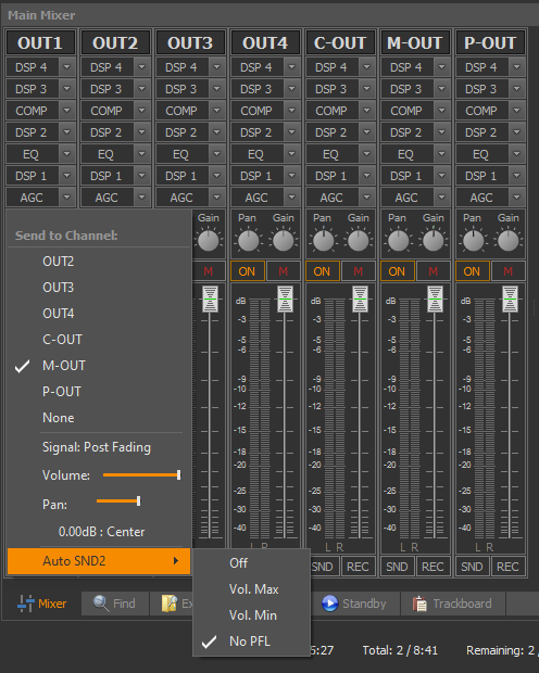

You asked for the SND screenshot(they are all the same on for OUT1...OUT4):
Just to clarify it's not SND that is being doubled as in two feeds coming only from SND to M-OUT. It's SND plus another route from OUT1 --> M-OUT and together you get clipping and the doubling effect when playing music from DECK A and when SND is on. You can see this from the screenshot1 and screenshot2. This extra route is not shown in settings or in output routing and doing something that triggers a reset of the mixer clears it and the sound stops as in screenshot3.
I've also found out that when this happens while playing music on deckA and use the PFL Player (SND is off), you now hear both DECKA OUT1 and PFL Player together not just the PFL Player. So it's deffinatly adding extra routing directly from OUT1 to M-OUT. I've had little luck isolating the issue today due to other issues that needed to be resolved. I will continue tomorrow morning(well later this morning... long days and nights).
