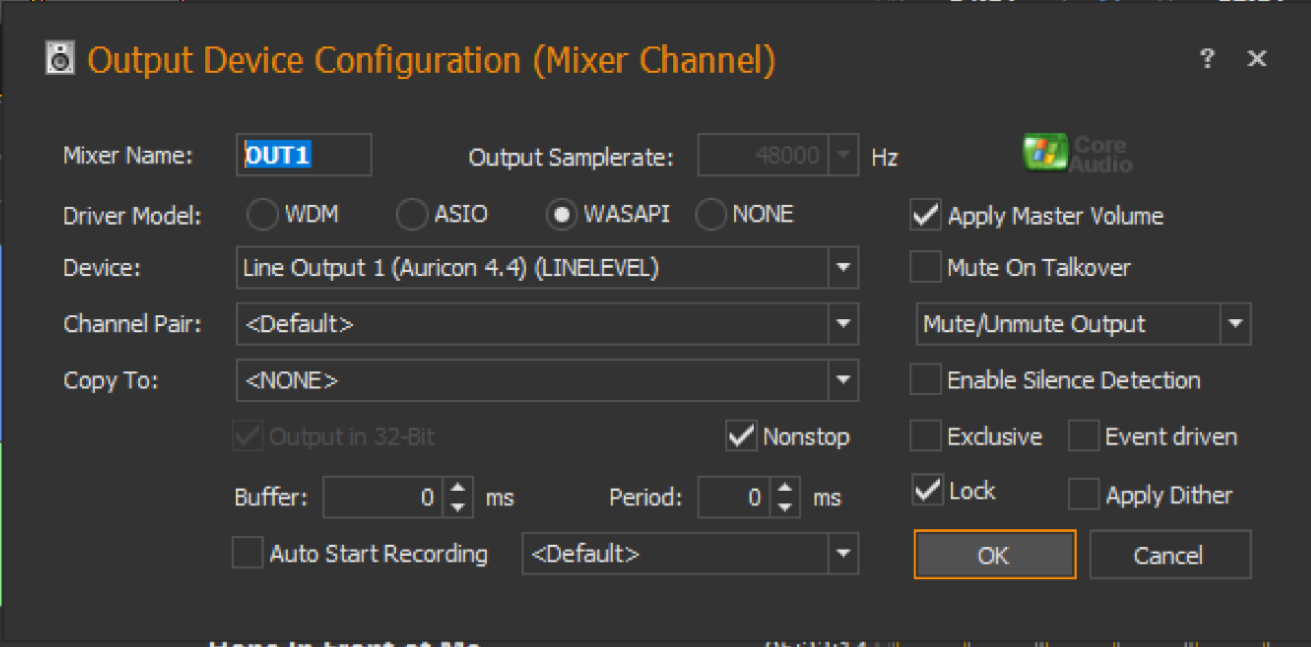

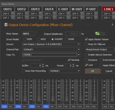

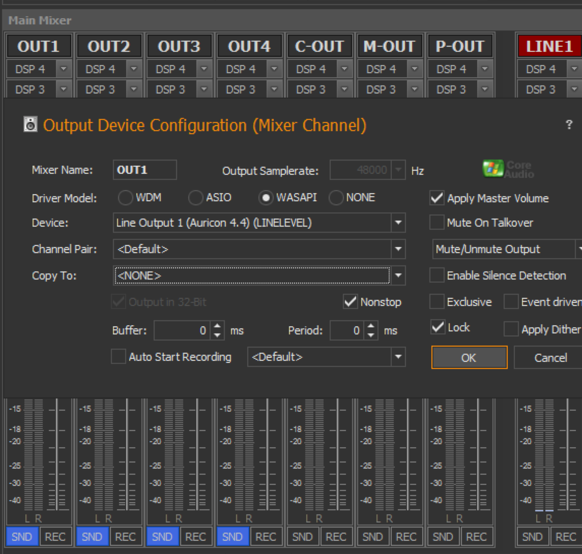

I've noticed when opening and closing PFL player using "PFL_FILE "and "PFL_CLOSE" the outputs would after so some time would for some reason start routing to M-OUT (the channel I made for monitoring via SND when not using PFL. it's like SND and copy are sending to the same output channel at the same time.
Right clicking on the channel and selecting edit settings shows that the copy to is set to NONE, but changing it to M-OUT (monitor channel) and then going back into to settings and changing to back to NONE does fix the issue until it happens again.
This is a bug or something I'm doing wrong?
For more clarity on this setup, when PFL is open SNDs on channels 1-4 are turned off, so audio is only heard from the PFL player that outputs to M-OUT when open and turns SNDs on again when closed. However, as mentioned above it appears that some times OUT1 would for some strange reason add extra routing when closed "COPY TO: M-OUT" giving the doubling effect but is not shown in the settings and to undo you would need to change COPY TO: to a different output like M-OUT and then back again to NONE:

As you can see form the screenshot on the first post, that’s how it looks when the issue occurs, nothing appears to have changed in the settings but the sound is doubled from OUT1 as if SND and COPY TO are routing to the M-OUT(monitor output), turning off SND does confirm audio is still being sent when it should not be sending anything once SND is off.
SND is used to send monitor audio to M-OUT, and when PFL is on SND is twitched off so they hear the PFL audio only and works fine.
But some times like today, after using the PFL via (PFL FILE and PFL CLOSE) any music played via DECK A(OUT 1) would sound doubled. SND is on as it should be when playing normally and sending it to M-OUT, but it appears to be sending the same audio twice to M-OUT from OUT1.
To verify if this is the case when it happened today I turned off SND, and M-OUT should go silent(as via SND is the only route it should get audio), but audio continues to be routed to M-OUT as if it’s copied the audio twice. The only way to resolve it(other than restarting ProppFrexx) is by changing as I said “COPY TO” from NONE to M-OUT close and open again and switch back to NONE.
Just to add it only affects OUT1, playing music via DECK B OUT2 is fine.
