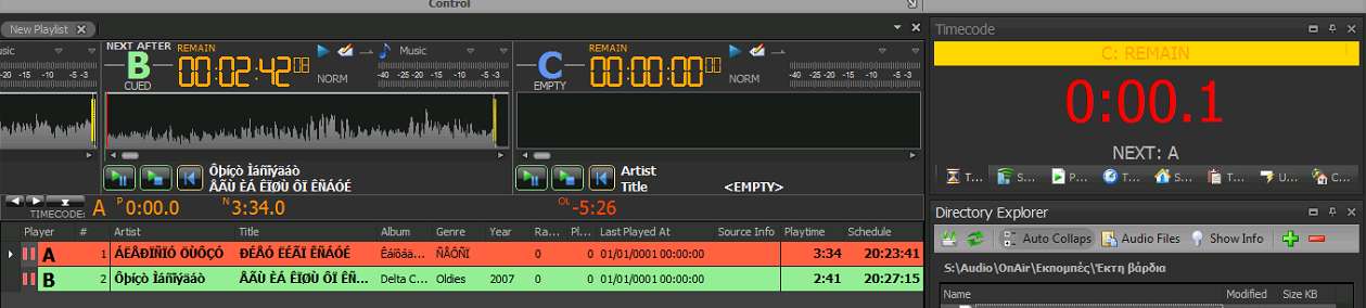

I am in live show, the track finishes, ejects but the Remain time of ejected song is still there.
Look at the following screens :

On the first screen the DJ Player B has finished playing and ejected but the timecode panel (as you see on the right) is still there showing that is not finished yet (need 100ms to finish).

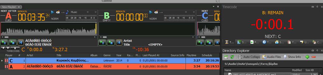

The same to the second screen for DJ C.
I thought that when a track finishes, the Timecode window shows the remaining time of the track ready to play.
Or am I wrong ?
