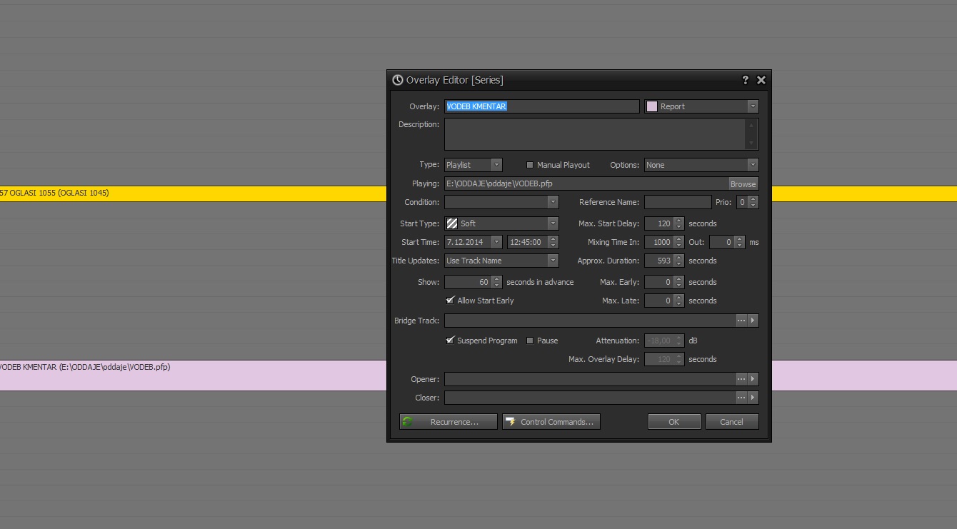

I use playlist . Firs I and every show I needed make as playlist and write it in overlay calendar.
b) What do you mean by "when I copy files..." - from where to where?
- If you copy a file to a new location, why do you believe ProppFrexx does handle this?
when I had all the shows whiten in overlay calendar I just copied the files with same name.
c) When you say "it cat it in time of original written time" - what do you mean by this - I do not understand?
- Please clarify in greater detail what you mean.
This worked perfectly until you did some changes to mixtimme in overlay, now if the file is longer than the previous show it cut it on previous time. Example file aktualno.mp3 is 23:06 lang and i copied with new aktualno.mp3 wich is 32:45 long it cut it on 23:06.

I try E.g. your issue might simply be, that you now need to specify a dedicated 'Mixing Time Out' for your overlay, e.g. 500 ?! but it doesn't work

Your .pfp does not contain any cue-points - so maybe you are using .pfmd files?
I just tested it here with 2 different .mp3 files (the first was 2 minutes long, the second was 5 minutes long) and they both played til its end and have NOT being cut a the end - so I can not reproduce your issue here!
Please try my other suggestions as posted above using a fixed Mixing Time Out of e.g. 500ms.

- Are you using .pfmd files?
- Did changing the Mixing Timing Out to 500ms help to resolve your issue?
