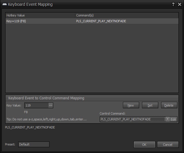

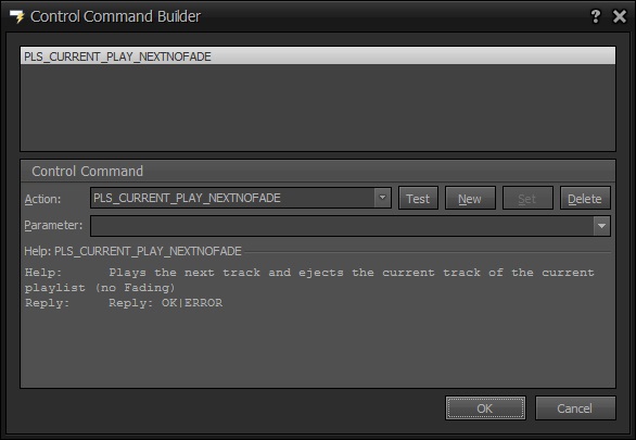

Re: Hotkey changing
No, we are talking about the same thing!
PLS_CURRENT_PLAY_NEXTNOFADE has NO parameter!
But PLS_PLAY_NEXTNOFADE has one.
So I guess you are using the PLS_PLAY_NEXTNOFADE and not PLS_CURRENT_PLAY_NEXTNOFADE.
Please submit a screenshot to verify!
Here are mine, as you can see PLS_CURRENT_PLAY_NEXTNOFADE has no parameter!
