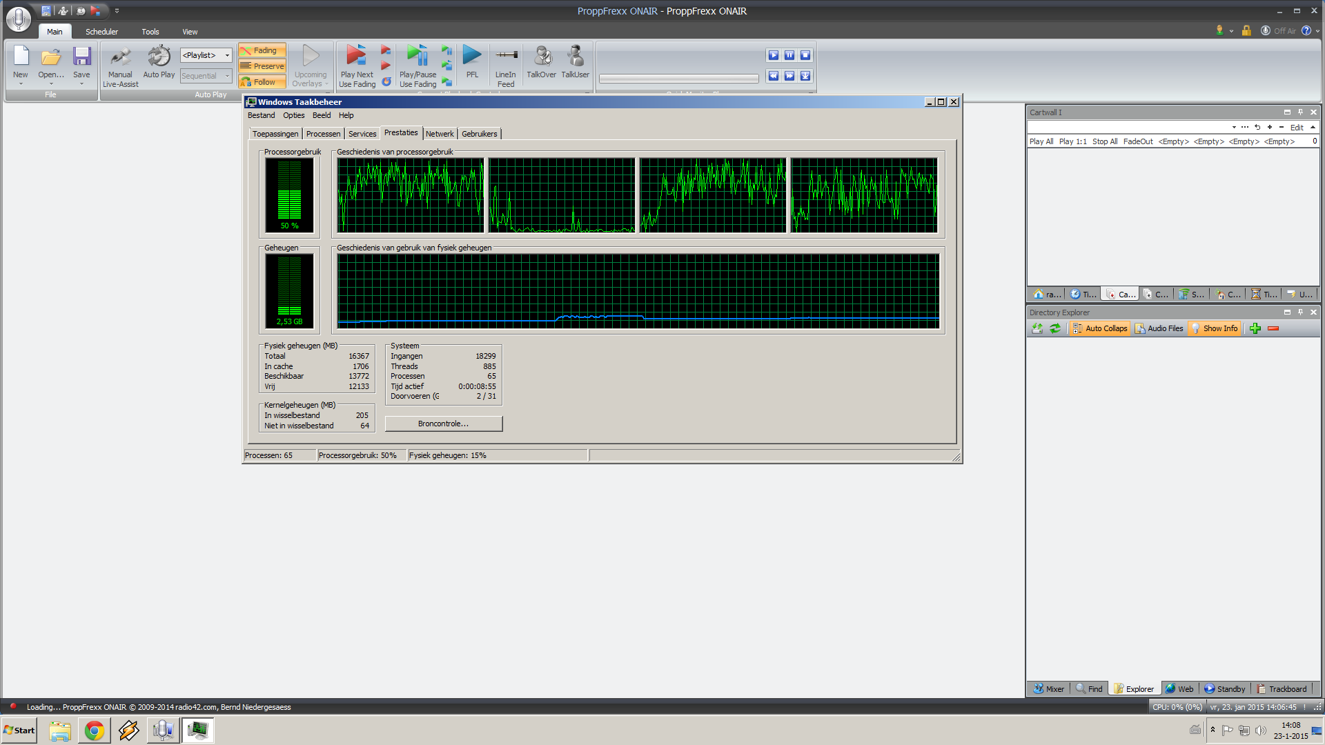

Since tomorrow, after i told you that it worked like a charme the program is constantly crashing
- This is what showes.
- Naamloos.png (153.39 KiB) Viewed 12503 times

As said, instead of reinstalling the OS again and again - you might first try to listen to the above and check what I tried to advise...that might have saved you from a lot of work...but...it is your decision
Re: PF crashes everytime
I guess you mean since yesterday or is it crashing tomorrow?
Form the picture I can also NOT see that it is crashing?!
However, what have you changed since yesterday?
Do you get any error messages?!
If it is a ProppFrexx error there MUST be an entry in the ProppFrexx 'Error.log' file, which is contained in the ProppFrexx AppUserData folder!
Please take a look into that file to see, if it contains an entry relating to the crash time.
If it is not a ProppFrexx error, but any other system error, there must be an entry in the windows event log!
So please also take a look there as well!
However, your memory consumption looks quite high (2.5 GB assuming you only run PF on that machine).
Have you may be added a lot of audio files to your media libs or added new media libs to ProppFrexx containing a lot of tracks (talking about hundered of thousand here)?!
If that is the case, it might be a simple out-of-memory exception!
In that case (I already pointed that out to you) you should try to use the Media Library Server, as explained here:
viewtopic.php?f=9&t=1014
