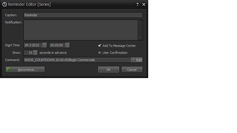

I have tested it in the program scheduler. After creating the reminder and hitting the "test" button it works correct.
But trying to schedule it in de program scheduler comes up with nothing.
Attached you'll find a screenshot.
Friso
Friso

That's a bit strange I just tested it here and it's working as expected. What are your recurrence settings?
