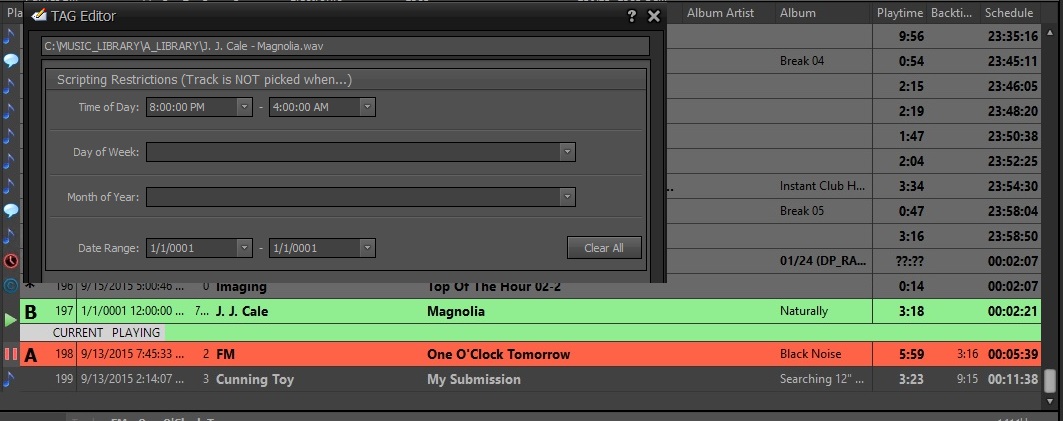

A bit confused with the Time of Day scripting restriction results.
From my understanding Scripting Restrictions define the time period when the track is not to be played. JJ Cale-Magnolia was entered as 8pm to 4am ... and the result i was looking for is that this track would be allowed to play from 4:01AM to 7:59PM (range includes noon but not midnight)
In the screenshot below - you can see JJ Cale Magnolia scheduled for 00:02 (midnight). If I want to restrict this track to only play between 4AM and 8PM (i.e. daytime) what steps should i take

Currently the TimeStart value must be smaller than the TimeEnd value.
But I can take a look to also allow your current setting in the next version!

Anyways, I still don't understand why a track that was restricted from being played between 8PM and 4AM was allowed to be queued at midnight? Are you able to replicate this on your end?
Re: Time Of Day - Scripting Restriction
Please see the first sentence in my above post for an explanation why this is currently not working.

In the new v4.0.0.17 the above mentioned limit doesn't exist anymore!
Meaning you can now define a restriction time range where the 'From' time is larger than the 'To' time (e.g. from 8:00 PM to 4:00 AM)!
