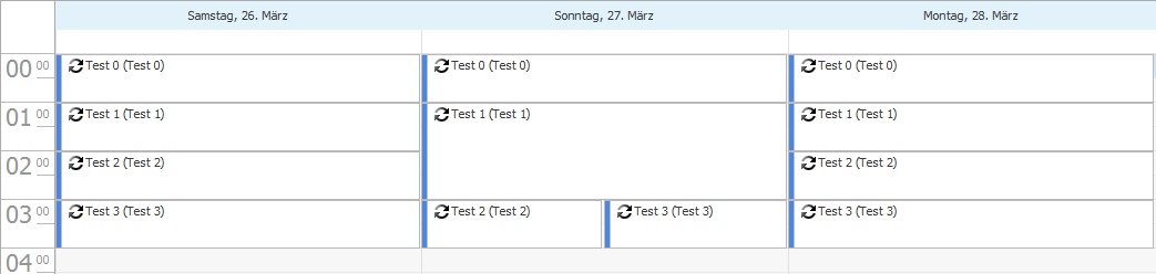

By default the scheduler component simply shifts all scheduled entries happening within the DST change time range by 1 hour. For example an entry which was supposed to start at 2am according to the standard time, will now be shifted to start at 3am (an entry which was supposed to start at 2:30am will now be scheduled to start at 3:30am ... etc.). The following picture (with 4 daily recurring entries) will illustrate this as an example:
DST Scheduler Example
As you can see in the picture, the 'Test 2' entry got shifted to 3am. In this particular case there is also another entry scheduled at 3am as well; as such 2 entries are scheduled in parallel at 3am. This would result in a conflict.
As there is logically NO generic way to resolve this conflict, you must resolve it manually!

In the above example, this would mean, that if 2 entries start in parallel, one of them would by default be suppressed. Typically this would effectively be the 'Test 3' entry. As such you should check your program scheduler manually. If needed, remove the respective entry occurrence (select it and press the DEL key; and choose to remove the occurrence and not the entire series).
