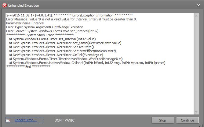

The last couple of days PFOA gives an error or the programm just freezes, so I have to restart.

- error.JPG (53.04 KiB) Viewed 16666 times

Please go to the general settings, section More Stuff and adjust the 'Alert Window Show Time:' value to a new value, e.g. 10 sec.
Re: PFOA gives error or the program freezes
I also just released a v4.0.1.42-beta in which I added an additional check to prevent this in case of wrong settings.

Part of the problem is solved after installing the beta and changing 'Alert Window Show Time:' value to a new value. The error popup as shown above doesn't popup anymore. But while using Voice-track the program often freez.
