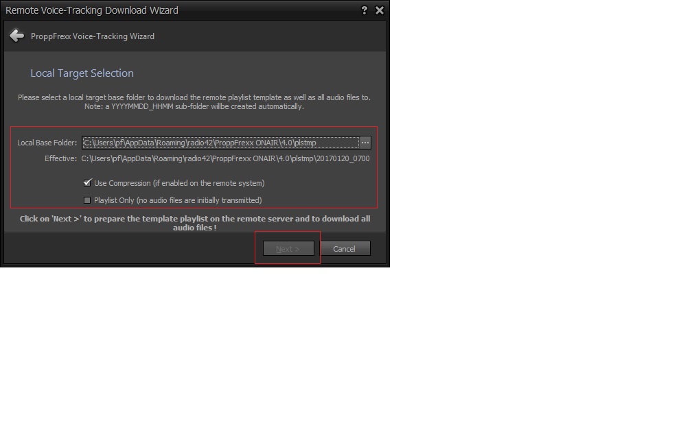

We are almost able to VT over internet. Everything works in the local area network. Now i was trying to download from my homestudio.
I get logged in.
Able to select the date/ time etc.
Then the screen local target selection, gives several options.
But the NEXT button is not highlighted, see pic
What can i do, or what is wrong?

The NEXT button is on that page ONLY enabled, if the "Local Base Folder" does exist!
So simply click on the '...' button to select a local and existing folder...

radio42 wrote:The NEXT button is on that page ONLY enabled, if the "Local Base Folder" does exist!
Works
Thxs
