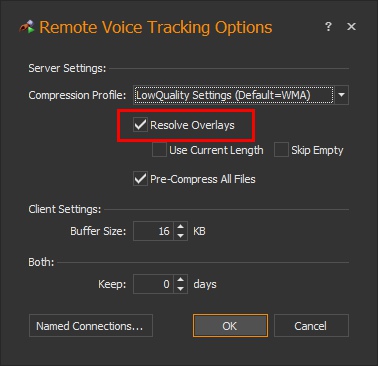

You need to set the option on the server side - see general settings, section Encoding/Recording and click on the 'More Remote Voice Tracking Options' - see image below:
RVT Settings.jpg (38.94 KiB) Viewed 7915 times
In addition you might in any dialog press the '?' icon at the very top right to display a detailed help about any option...
Resolve Overlays:
If checked, overlay scheduler entries will be resolved to remote playlists during remote voice tracking.
This means, that the resulting playlist template will contain dynamic overlay reference entries. This will allow the remote DJ to recognize the exact location of the overlay playout and align his voice over accordingly. This however also means, that the overlay playout is triggered via the playlist itself and that the DJ might change or even delete those overlays.

radio42 wrote: This will allow the remote DJ to recognize the exact location of the overlay playout and align his voice over accordingly. This however also means, that the overlay playout is triggered via the playlist itself and that the DJ might change or even delete those overlays.
Ohh that is tricky, we have to be sure to use this option.
Re: News and Avertising, and RVT
That's why it is placed to be configured on server-side - so a client cannot change it ;-)
