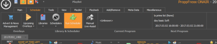

I just had an update, and when The program restarted.. Nothing happened,
Pf did not loaded the playlist, and the VST that was inserted in the mixer didn't showed up too. (auto play and run scheduler was active)
I manually loaded the playlist from the scheduler... But I'm afraid the next playlist won't start as expected.
the Playlist playing at the moment runs till 4pm and was remotely voicetracked. Need help, please !
Thanks,
Thomas.
moogwill
Posts: 420
Joined: 28 Feb 2016 12:31
Re: no playlist @ startup
Post by moogwill »
seems the expected following playlist is indicated in the next playlist indicator, but I can't understand Why it didn't start... will it start as expected?

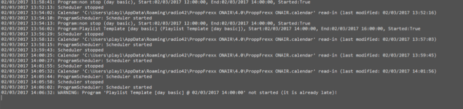

here's the log's screen cap

maybe it was'nt a bug but a wrong action I did.
Just tell we If I'm wrong: I think the restart of the program was too late for the loading of the remote voicetracked session.. that's probably why nothing showed up. So If this is the reason, what option do i need to check to resume the previous playlist at the closest expected time ??? You can move this topic to questions if it's not a bug (As I just had this trouble after a update, I first thought It was)
thanks
The only start option you probably don't want to check in your case is the "StartNextProgramOnly".
All other start options might then also be left unchecked.
When the Scheduler is started (either if you click on the 'Run Scheduler' button or because it is started automatically at startup) it always tried to determine the 'initial' program to start.
According to your first screenshot - this must have been failed.
The only reason why this might happen is maybe because you have not defined any program for that time?!
Hard to say, as I would need to 'see' your program scheduler to validate this.
E.g. do you have specified for that given time a program within the program scheduler.
(maybe you have specified a previous program, but that is not covering the full time in the scheduler?)
