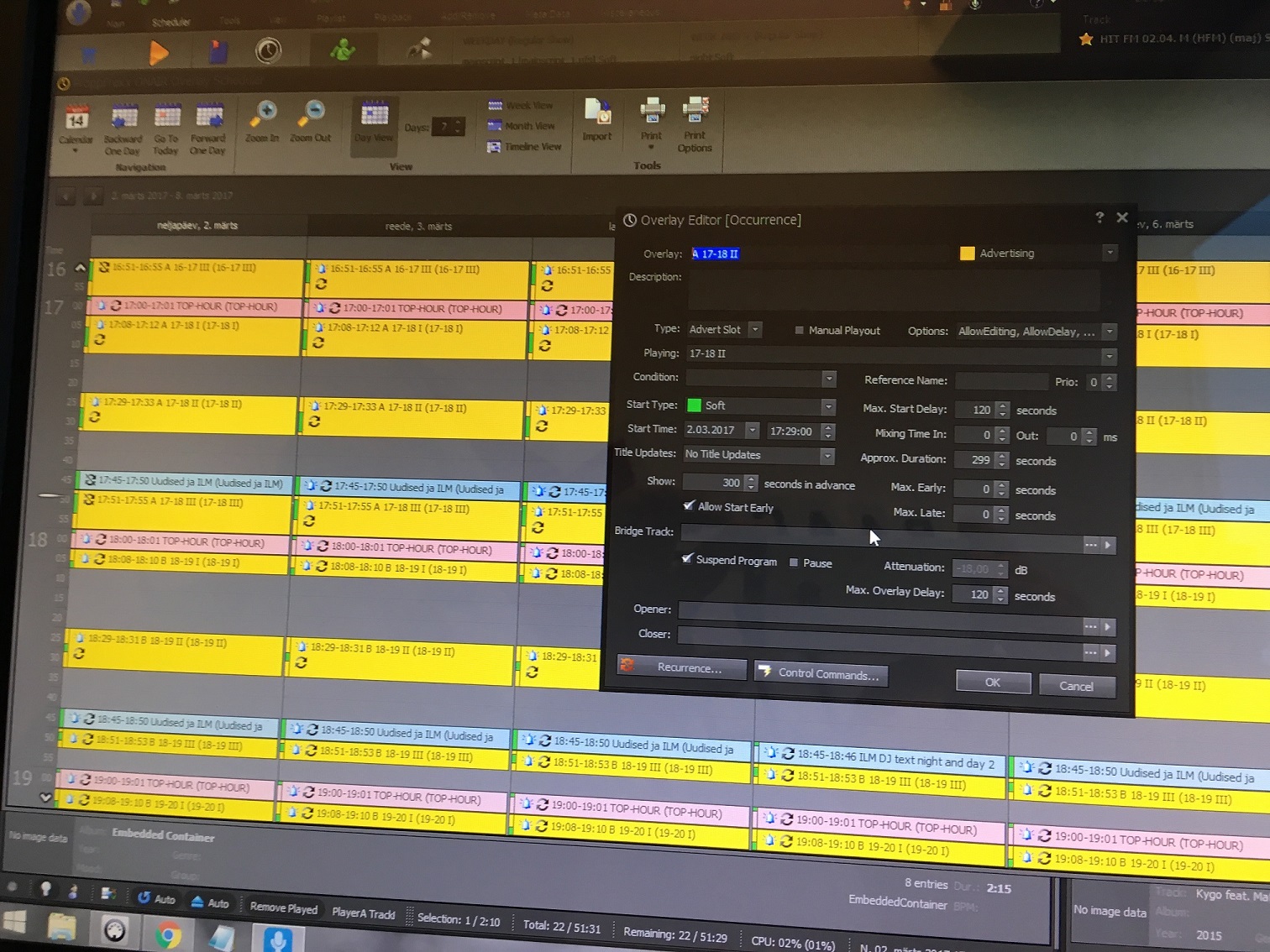

Hi!
Now I have some pictures about this situation. Shortly; I have scheduler for announcements and advertisement example 18:45 https://www.dropbox.com/s/f4boni2b16gkv1l/1.PNG?dl=0
There it seems all right. Loading is set to 900sec before starting time. Problem is that randomly all schedul's will not loaded (both anounc. and ads.). After missing loading and starting/executing this on time in the scheduler "show second in advance" is "0"

For your screenshots all looks fine!
You have scheduled an embedded Overlay Container to your playlist (see your movie link, currently loaded into Player A).
Whenever an embedded Overlay Container is used in a playlist, this means, that NO other Overlay is further automatically used from the Overlay Scheduler.
This is a global policy to prevent duplicate or mixed playouts.
I.e. either schedule and play ALL overlays through the Overlays Player OR resolve and play all overlays through the playlist.
You cannot mix both modes!
As explained above, once an overlays scheduler entry was triggered (no matter if played or missed) its 'Show in Advance' time is reset to 0.
All works as designed.

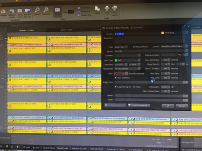

Ok, I think our discussion missmatch. Let's talk for starting again only about first problem; I have scheduled adds. or anounc. blocks in " Calendar". Goal is: they should appear to playlist automaticaly "softly" 300sec or 900sec before actual executing time. 2 years it works without any problem. Now happens this randomly; sometimes adds or announc. block will be loaded to playlist and played and sometime not - why?
For us is this serious problem and is important to find reason whether is it bug or configuration question.
About you're comment: "once an overlays scheduler entry was triggered (no matter if played or missed) its 'Show in Advance' time is reset to 0." It's not true; here picture where adds are played and 'Show in Advance' is still 300sec and it's so with any played adds, or announs. block. To 0 it will be reset only in missed blocks.
