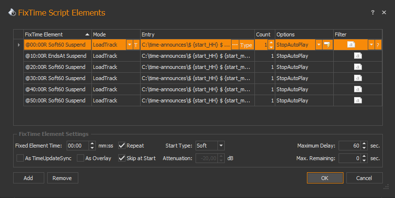

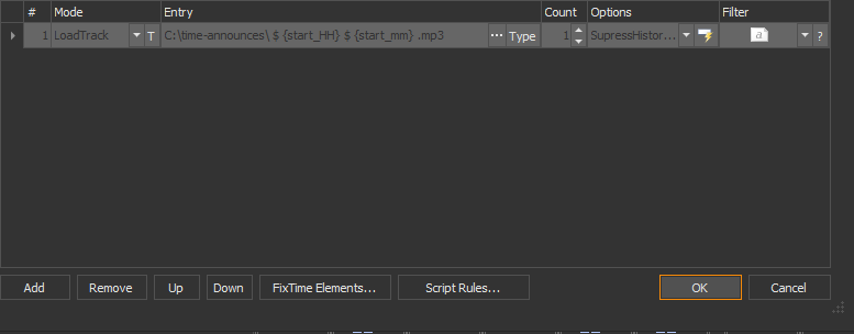

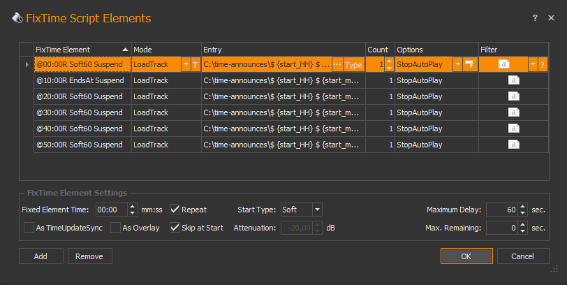

Hello good night I'm having trouble setting the right time I did it exactly according to the tutorial, but it did not work, maybe I did something wrong, please see the photos of the settings and tell me if there's something wrong?
Re: Right time
There should be no spaces between $ and { etc.
Not
$ {start_HH} $ {start_mm} .mp3
But
${start_HH}${start_mm}.mp3
