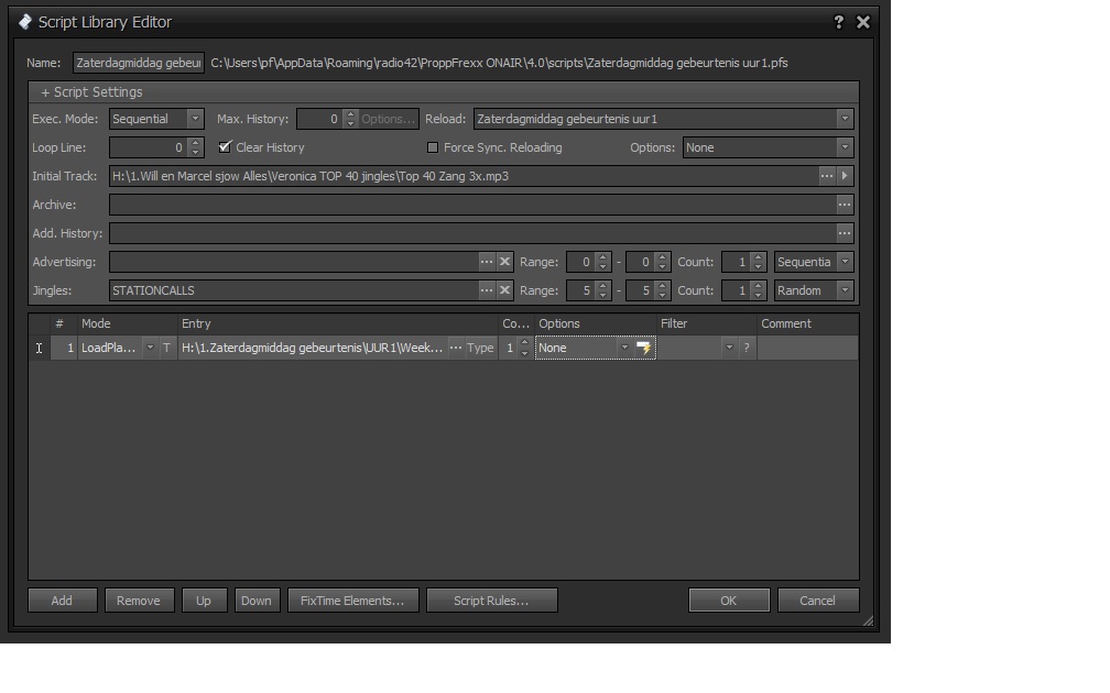

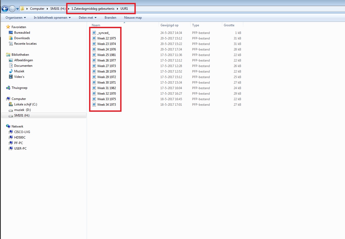

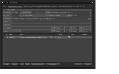

The show is once every week. The total is 3 hours. The guy already made playlists and seperated them in different folders (uur1, uur2 etc). Now he wants to voicetrack them from his home (client). But he is not allowed to work at our playout system (Server)
Now when he selects a future date but RVT list he always provides him with the same one. Did i designed the script rights (see pic2)? ENTRY Says : H:\1.Zaterdagmiddag gebeurtenis\UUR1\Week 31 1982.pfp The second one is the folder structure.

Re: Making playlists for Rvt
Yes, I understand, that he wantsa dynamic way... and that is why I explained how to use macros in his script line...
E.g. instead of using:
LoadPlaylist, Z:\SomeFolder\Week-21.pfp
you can use:
LoadPlaylist, Z:\SomeFolder\Week-${start_week}.pfp
This will resolve dynamically to the effective file name at runtime... depending of the effective week you have selected...
