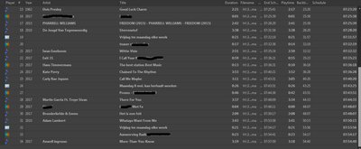

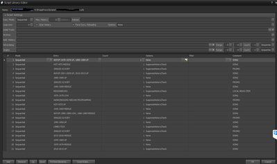

Strangly enough, since the start of this week the scripts also looks totally different from the loaded list for VT. See the pics.
PF03 in the script.
PF04 and PF05 shows the selected playlist. I already tested the script with random instead of Sequential. It shows no difference.
I've selected 15 songs and 6 promos and i'll get a lot more.

For the screenshots:
Being honest, I can absolutely not follow with what you mean?!
You showed above 1 script file and 2 playlist files, so?:
- how are they related?
- what is wrong?
- why are so many entries scratched out? (what do you want to hide here?)
- what is your expected result?
-> Finally what do you expect me to discover in your pictures?
I am a bit lost here!

radio42 wrote: 05 Jul 2017 16:50
1 how are they related?
2 what is wrong?
3 why are so many entries scratched out? (what do you want to hide here?)
4 what is your expected result?

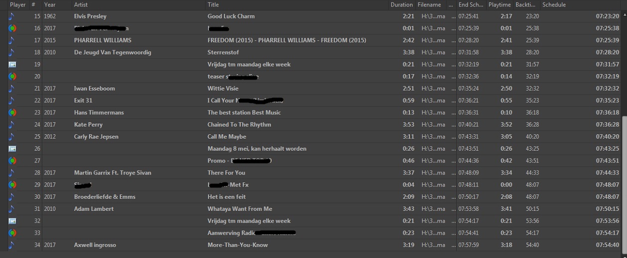

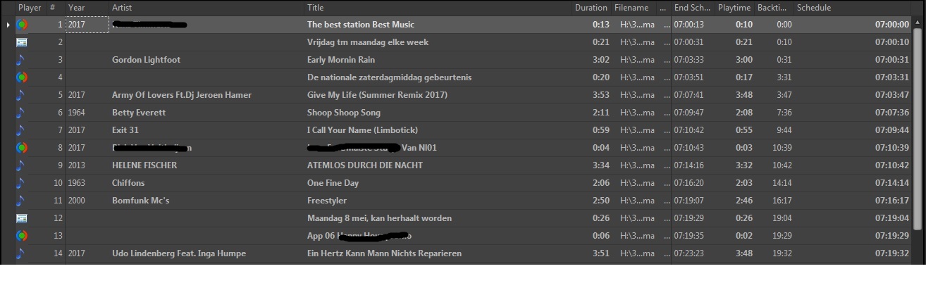

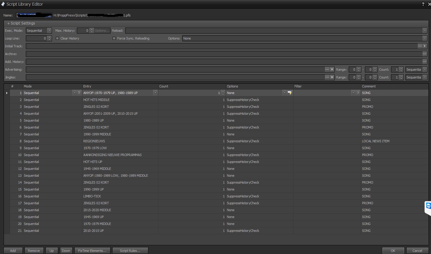

1- The script is called, the other 2 playlist are the result. I start asking start with a song and PF picks 2 files from other folders as you van see.
2- The script should be like the playlist?
3- There is nothing to hide except the names of the DJs ( private info for users only)
4- My expectation is that the script shows what i ask. Not a lot more ( see the first 3 lines in the playlist, that does not realate to the script. So something most go wrong. Question is, what and were.

Again, the playlists Together is one playlist. Just look and you can see that it is one playlist, a result from the script.
The one you already saw.

Re: Songs in dbase played les then 40 seconds
OKay, 2 screenshots = 1 playlist - understood.
But what is wrong with it? What has this to do with tracks playing too short?
I just see a script with script-lines, I have no idea what tracks are contained in each media lib.
How should I guess what tracks or order or whatsoever is wrong in your playlist?!
Either you start to explain your issue in must more details or we can simply not continue here... I am not a clairvoyant...
I simply do not see what is wrong with your playlist - so please explain.
I still do not know, if it is the playlist generated on the server or the playlist as transferred to your client?!
And I still do not understand how this related to your post's topic... I am sorry!

Oké, thats fair, i compressed to issues in one topic, i see were you lose your clarity.
First, i will send the files from our dbase who are 40 secs long, and will stop rambling on.
Secondly related to the screenshots, for me thats clear.
The hour opens with a song, it starts with a jingle, that a promo and than the song. The script starts with a song, my question was, how can that happen? I get the point were PF fills the hour with music, but more than one jingle? I ordered by script to take only one instead 2.
I hope you get my point otherwise i'm not able to express the problem.
This playlist is automaticly generated on the server for a VTrecording.
The script worked fine, till now. Nothing changed. But now the script makes his own way. You can see that. Just compare the script with the playlist and you can see the difference. Simply said, the sript doen not do what i've ordered.
