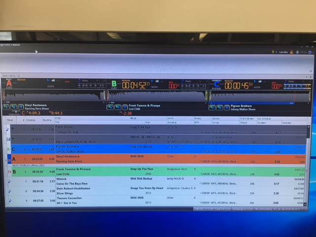

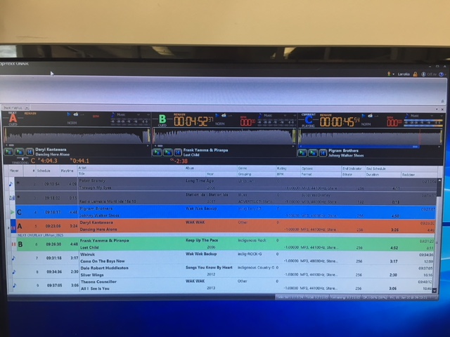

Hi Bernd, sorry for not explaining clearly. In the video I do 2 drag and drops of the track "Black Woman".
The first I drag to the bottom of the playlist, over the track "Domestic Violence" by Sandridge Band. The song doesn't get added to the playlist. (It used to appear at the bottom of the playlist no matter where I dropped a track).
The second I drag over track 4 (top of the playlist after the tracks that are loaded into the DJ players). The track loads in at track 6 slot pushing the other tracks down. I can then drag the track to the bottom but it's not what used to happen and a bit confusing for our broadcasters who are trying to set up specific playlists.
When I use F12 it places the track at the bottom of the playlist every time.
I've added a pic showing that I don't have any sorting on the list.
Thanks
