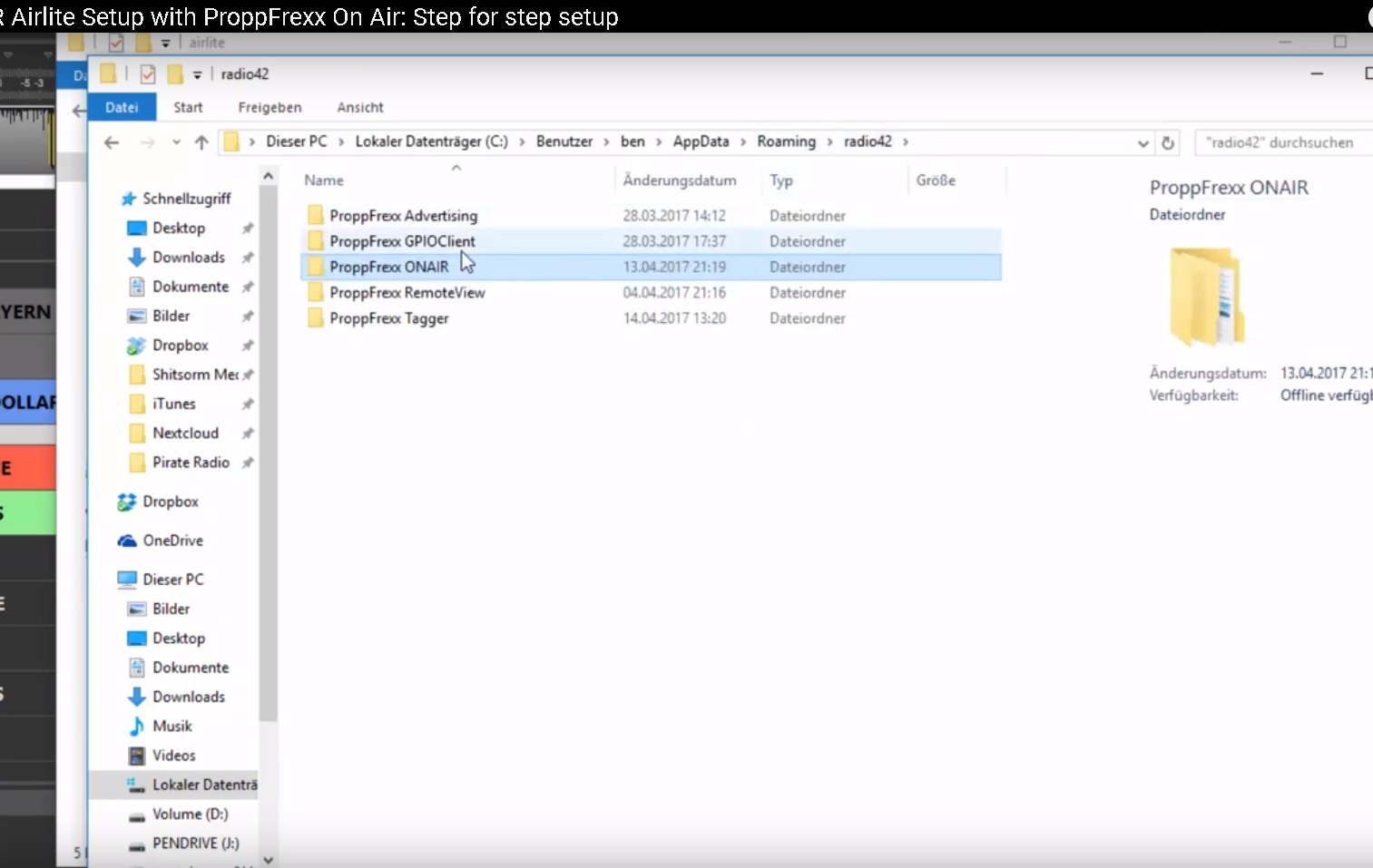

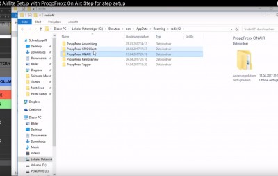

This is a printscreen from Benjamin's Youtube video (https://www.youtube.com/watch?v=IfZiGkI ... e=youtu.be)
I, on the other hand, strangly does not find folders as Benjamin refers to. There is no GPIO Client folder where i can drop in files.
Posts: 9160
Re: D&R Airlite
Guess you just create a new and empty one yourself.
