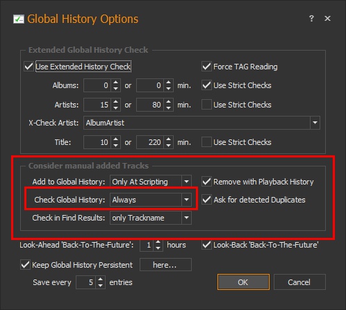

I've been trying out the demo before purchase of Proppfrexx ONAIR, and I'm impressed with the features, but I've noticed one issue I'm struggling to resolve.
I've noticed I can add the same artist(or even track) many times, and play them back to back without any notification or highlighting of played artist,album, etc, so our presenters could end up breaking the rules with regards to seperation. How do I turn this feature on?

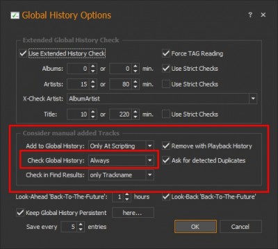

Well, it depends how you use ProppFrexx.
Note, that ProppFrexx has various histories. These are best explained here: https://youtu.be/fJknoxnXOAQ
As I assume you are talking about the manual preparation of playlists, you can adjust this in the general settings, section Logging/History any by clicking on the 'More...' button next to the global song history settings: Especially the marked 'Check Global History' option sounds like is what you are looking for.
