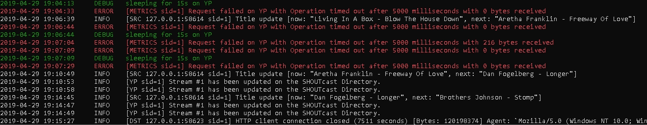

Hi, anyone familiar with problems new SHOUTcast DNAS v2.6.0.750?
tried everything but keep getting the following messages:
ERROR [METRICS sid=1] Request failed on YP with Operation timed out after 5000 milliseconds with 0 bytes received
DEBUG sleeping for 15s on YP

Re: SHOUTcast DNAS v2.6.0.750
The YP operation is the update of the SHOUTcast directory service.
It seems, that this issue might either be related to a local firewall issue or an auth-id/authhashtag issue (e.g. users report, that changing the authhashtag might help).
There are a few posts on the SHOUTcast forum not related to ProppFrexx, so I guess this might be a general SHOUTcast issue, which is unfortunately unrelated to ProppFrexx - as ProppFrexx doesn't update the YP.
Here are some tips form the SHOUTcast forum (as it seems to be a known SHOUTcast issue):
1)
This worked for me in addition to what I mentioned above:
Remove the authhash line in the sc.serv.conf file. What for a couple of hours untill your stream in removed from the Shoutcast Directory.
Re-generate a new authhash.
Add the new authhash in the sc.serv.conf file. Now the update will be done and no errors occur anylonger.
2)
The issue (ERROR [METRICS sid=1] Request failed on YP with) is solved since yesterday for 3 of my streams. I use the beta 2.6.0.751.

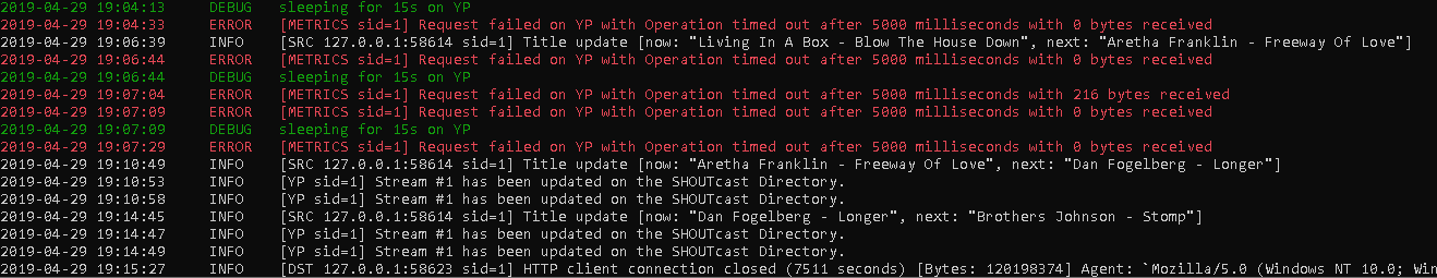

Hi Bernd, I think it's a general SHOUTcast issue. I reset the windows firewall, even turned it off!, authhashtag renewed, no result it is noticeable that it appears irregular. if anyone has any tips then I would love to hear from you. thanks in advance
It is striking that line after update title (next song) is often shown twice?
2019-04-30 06:44:24 INFO [YP sid=1] Stream #1 has been updated on the SHOUTcast Directory.
2019-04-30 06:44:26 INFO [YP sid=1] Stream #1 has been updated on the SHOUTcast Directory.
