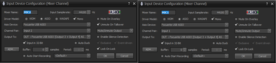

could it be, that one of your mixer input channel doesn't have the 'Unmute on TalkOver' option set.
As only those mixer input channels are considered in the ONAIR state (the ones, which does have this option enabled).

Unmute on Talkover is on at both channels
