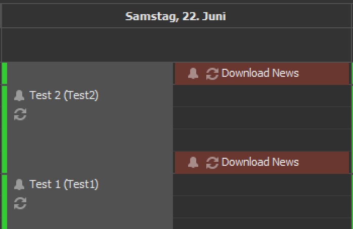

Sounds good. Note, that you could also have used a Reminder in the Program Scheduler to trigger the download.

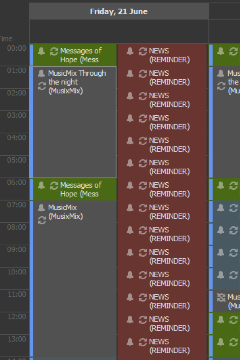

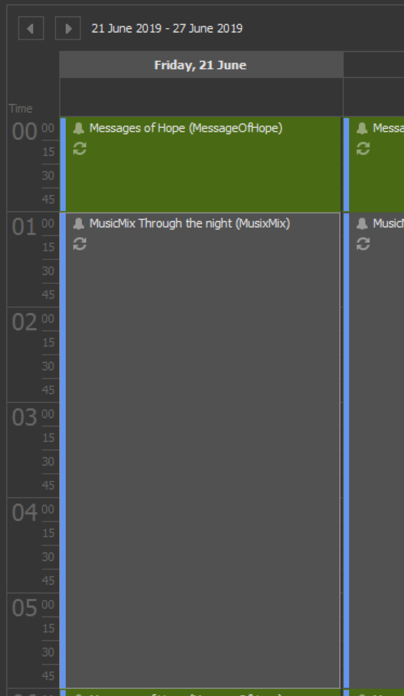

I tried that idea before coding a solution but maybe it’s just me but the extra red reminder boxes that filled the complete schedule each hour next to existing programming, made it more complicated to read and edit.radio42 wrote: 21 Jun 2019 07:00 Sounds good. Note, that you could also have used a Reminder in the Program Scheduler to trigger the download.

Not sure what you mean?!
If you are having a program and a reminder side by side - both take half of the day in space... nothing special or strange to work with.

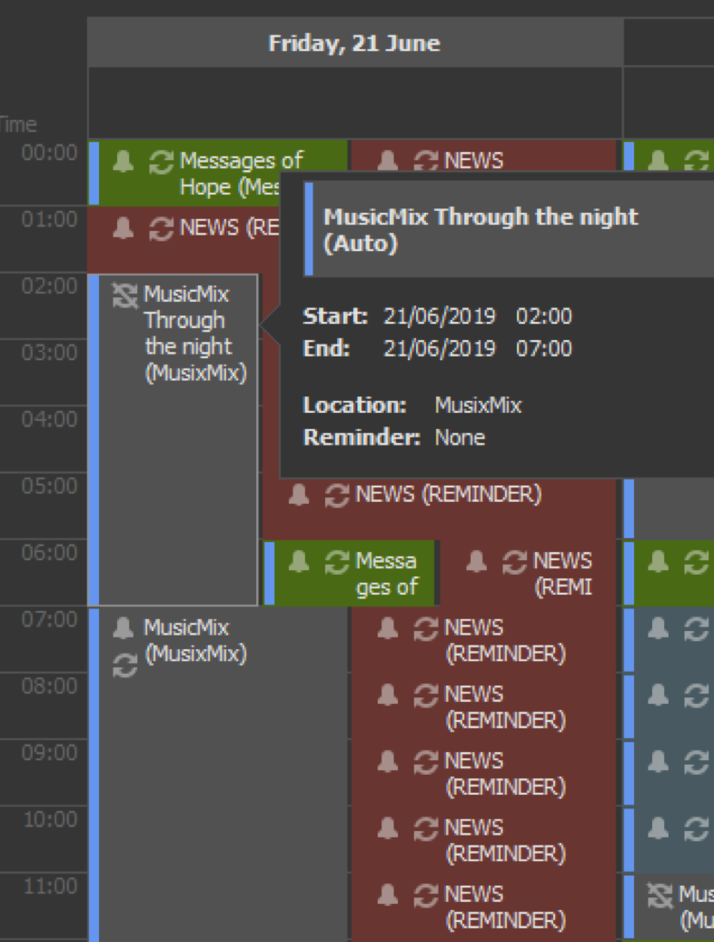

It just made it less clear in my opinion. Personal preference maybe. But this is why: and moving things around could confuse the people here using it and even end up deleting the news download by mistake: So I decided to keep it plain and simple by making a script to do the job outside of ProppFrexx:radio42 wrote: 21 Jun 2019 15:10 Not sure what you mean?!

As a thought.. you could add a "hide reminders" option to hide the reminders when editing the programme schedule.
Just an idea.
Just an idea.
