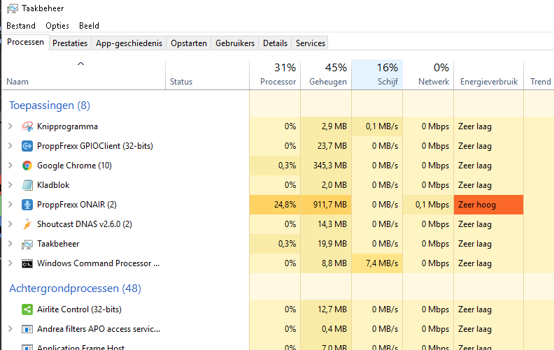

Bernd, Is the memory use of more than 900MB (very high) normal? I am experiencing a slower performance of PF despite reinstalling it. Computer is not used for other purposes (I7 and 8MB).

Yes, 900MB is normal. But it depends also on your Media Library use and others, like e.g. using certain VSTs.
If you want to reduce that, consider using the Media Library Server, as explained here: viewtopic.php?f=9&t=1014#p3914
The CPU usage is however pretty high. Could it be, that you are using the StereoTool VST with maybe pretty complex settings?
If yes, try removing this and see, if that removes the slower performance.

I do indeed use StereoTool VST with complex settings. Meanwhile a few older versions are trying where it is striking that the most recent use more MBs. I am going to work with the MLS (I have been using MLS with RadioDJ for a while). Thanks for the reply
