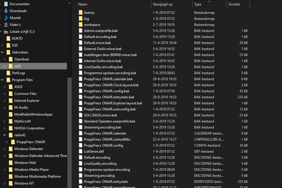

Please make sure, that the path "C:\Users\pf\AppData\Roaming\radio42\ProppFrexx ONAIR\4.0\log\" exists and that you have access to it!

Hi Bernd, back from my holiday. Make a fresh start.
The folder exists, PF just does nothing.

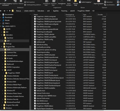

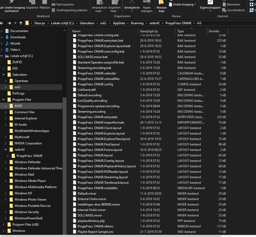

For what it's worth, PF does not start at all. I can use the pic, open in the C directory,... i'm cunfused. What will be the first thing PF will do after you activate the app?
