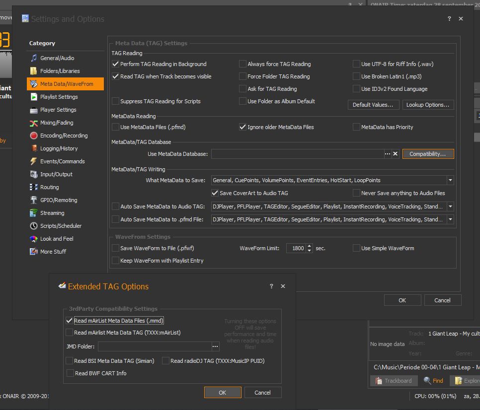

I just did a clean installation of the latest version on my test machine. I fully reset all my settings and enabled the option to read the `.mmd` file.
The testing directory contains `.mp3` files and the `.mp3.mmd` files.
I've tried to add it as a media library, as well as just drag it from the explorer into a standby printer.
But as far as I can tell, the cue points are not read. If I click 'show tag info' on the file, before it's loaded into a player, both from the media library or explorer, show no cue/ramp points. After I load it into a player, there are some points, but they seem to be auto generated and the Ramp1 is missing.
Am I missing something?
I've attached a screenshot of my settings. The `.mmd` files are still the same as the example above.
Metadata settings
Metadata settings
Re: Cue points from MMD metadata
Maybe, I don’t know. You need to provide me with your files to test here. The ones you send me did work here.
As said, if some cue-points do already exist in the mp3 file, it would use those!
So please provide some sample files to test with.
